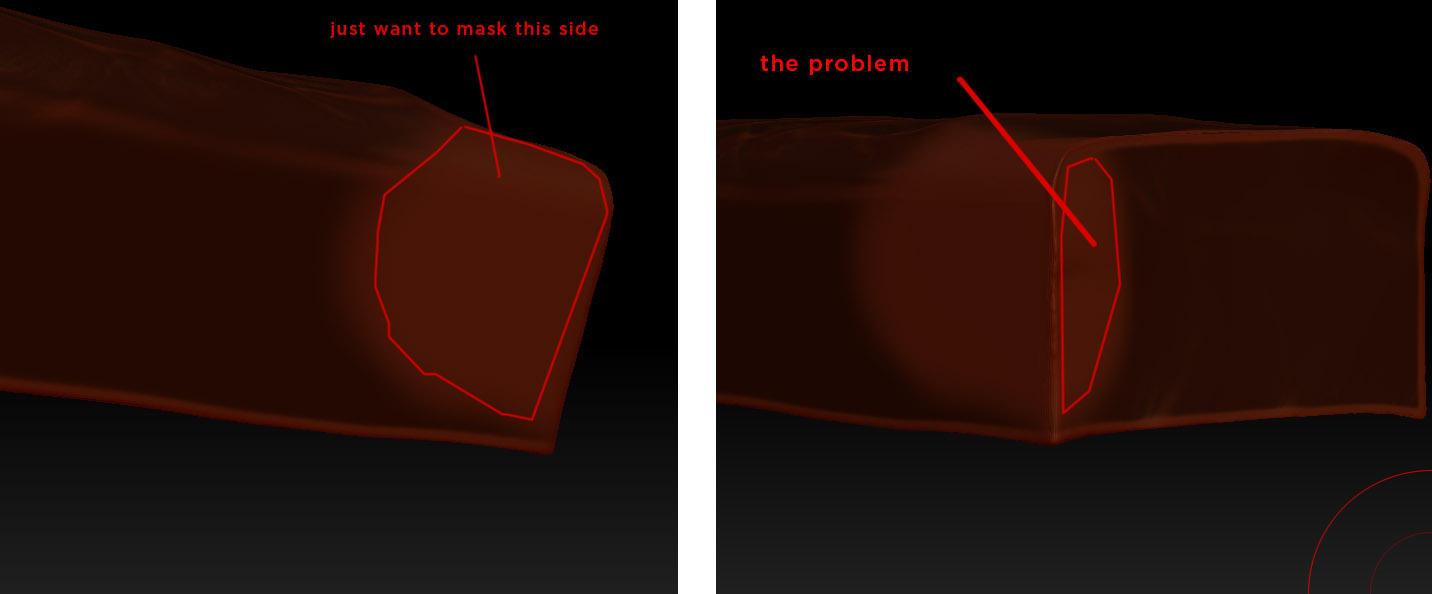

I am trying to mask one side of a chocolate bar I am making, but the masking is going through to the other side, how do I prevent this and have it stop at the visible edge? (see attached file)

Mask by polygroups( you night have to create them)(crank to 100%)( or backface mask.
Sometimes it’s lots faster to mask all, then erase, then invert.
Use Backface Masking, and make sure you enable it while in Mask mode.
Thanks guys, that worked.
