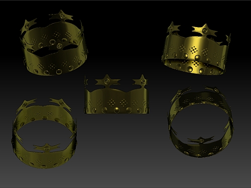

Note: Edited to correct my explanation of the process for beginners who might try this. Below I stated after making polygroups to delete the top, bottom and BACK, leaving you with a cylinder. There would only be a “back” to delete if you start with an open tube/cylinder form. With a primitive cylinder there is no backing to delete. I hope that this is a clarification and not more confusing.
Cynwolf, I think you would do better by using “mask by alpha” in the mask subpalette of the tools palette. Play around with the Horizontal tiling in the alpha menu to get the number of radial repeats you need and then apply the mask as I described. You may need to play around a bit with the vertical tiling or the mask itself to get the position exactly as you need it, as well as later
applying a rectangle drag mask to the bottom to mask.
I’d start by taking a cylinder and (ctl shift) hiding the top and bottom edge, then using the autogroup feature in the polygroup subpalette.
Then I’d click to hide the edges and back polygroups and “delete hidden” in the geometery subpalette.
I’d mask what remains with the mask by alpha feature described above and use additional drawn or rectangle select masking to perfect my crown. then I’d select “make polygroups from masking”.
I’d once again hide/delete the parts I don’t want.
Finally I’d mask it all and in the subtools palette set my desired thickness and “extract” the final form via the subtools palette.
Disclaimer: I’m famous for “complicating a ham sammich”, so there may be a quicker, better way, but this works for me!
Thanks Nancyan,
It worked perfectly for me, great tip - I really appreciate you taking the time to respond to my query.
