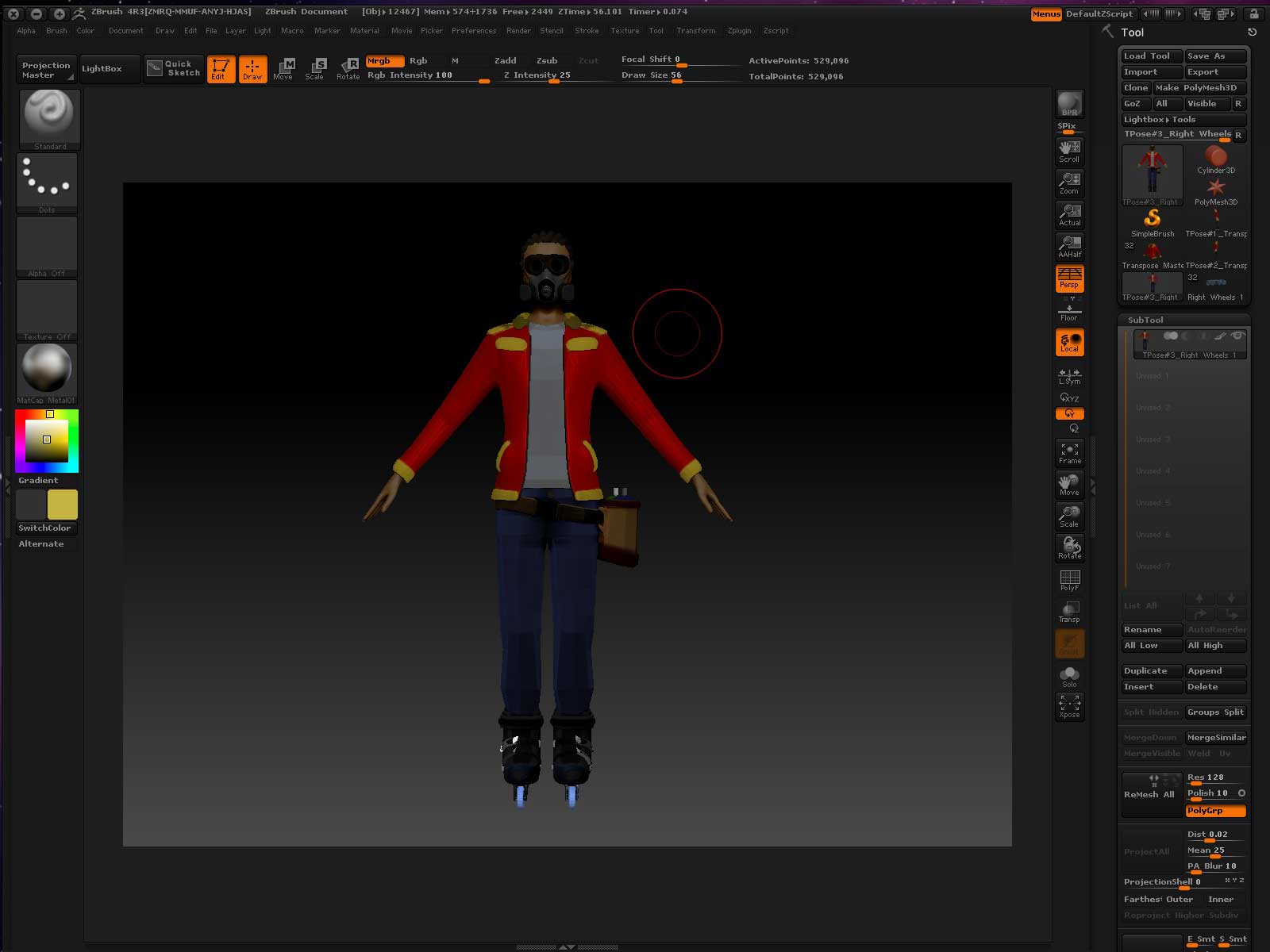

I am creating my very first full character in Zbrush and was looking for some help with an error I am having. I am trying to use the Transpose master to pose the character, but I discovered that I am having invisible masks on my character. I tried moving him and found that I couldn’t move some things. Upon inverting the masking selection, the masks became visible, but I can’t seem to get rid of them now. If I try to erase them they just move.

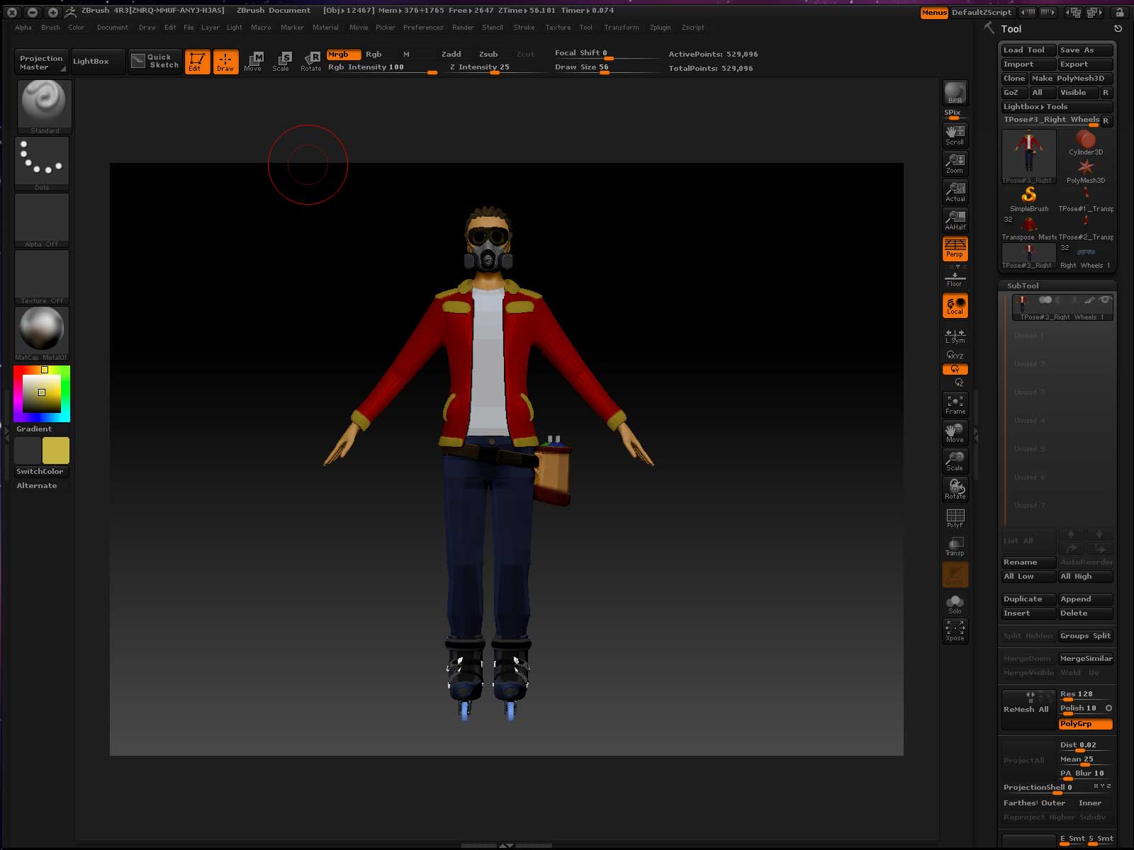

I have attached two images. One of them is before I inverted the mask, the other is after. If you look closely, you can see the wheels and the jacket, and one spray paint tip is unmasked while everything else is masked. If I inverted the selection from there, the jacket, wheels, and the tip of the spray paint can is masked and everything else is unmasked. Can anyone help me figure out what I am doing wrong and how I can fix it?
masking>clear
That should clean that up.
You also want to remove all masking from all subtools before entering transpose master
