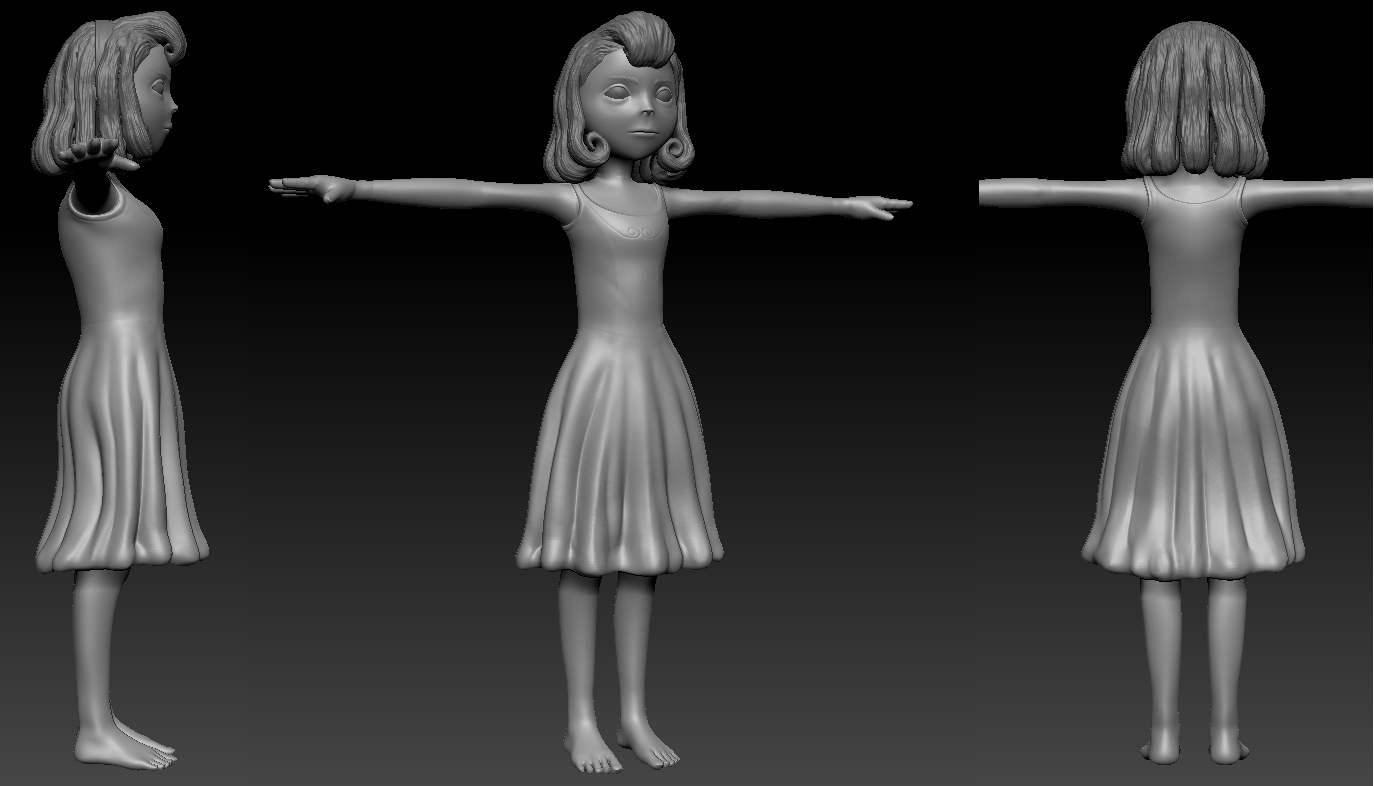

I want to show you some behind the here because i deeply used zbrush from sets to characters.
I won’t detail all the sets and characters but i want to go through few of them.

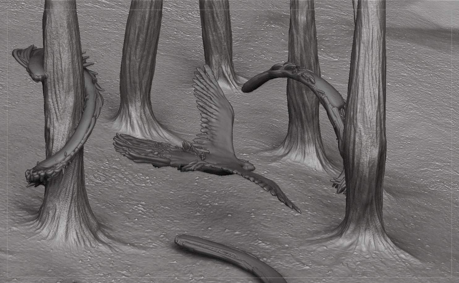

The first one is a “giant” tree : I made the basic geometry in maya and after everything was in place, I begin sculpting with zbrush. I like using the clay brush to build up the forms and after that dig in with specific alphas.
I have not spent to much effort on adding lot of details because i knew the 3D printer will somehow smooth that out but I took care to accentuate them.
Actually, i was surprise how far the printer (Form1+) was able to perfectly recreate the shape.
