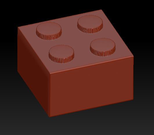

I tried making a new alpha for the top cylindrical connectors on the top of the lego brick, using the Cylinder3d, and then symmetrically drawing this new alpha onto a brick shape I made with a Cube3d. This works almost perfectly, except for some reason the alpha cylinder gets drawn with a tapered/rounded top. I can eliminate the rounded top by decreasing the Focal Shift setting to -100, but the cylinder is still slightly tapered. Instead of getting smooth looking cylindrical connectors I am getting something that looks a bit like an upside-down Reeses peanut butter cup. I will continue to play with it. I have attached a sample image.

what brush were you using to make the cylinders? standard brush with the style switched from free form to drag rect?
When I am drawing on the cylinder alphas I am using the regular brush with the Stoke style switched to dragDot (not dragRect).
You could potentially get much better results if you use the right topology, but ultimately its not worth the effort - you will get the best results using 3ds max or similar for this type of modelling.
Thanks Blight. I think you are right. ZBrush is great for some things, but not lego type objects perhaps. I can see that 3ds max is a better choice for this type of modeling …
