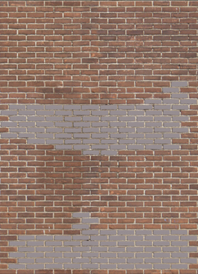

I making a normal map for a low poly building. Only problem is that this method of placing individual bricks on the canvas takes way too much time. Here’s one hour of work and I’m not eaven half way through the process.
[bricks.jpg](javascript:zb_insimg(‘155082’,‘bricks.jpg’,1,0))
Is there a faster way of doing this?

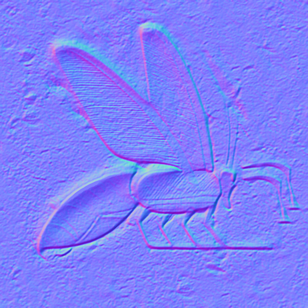

i’ve done some tests with both ShaderMap and CrazyBump. ShaderMap does great.

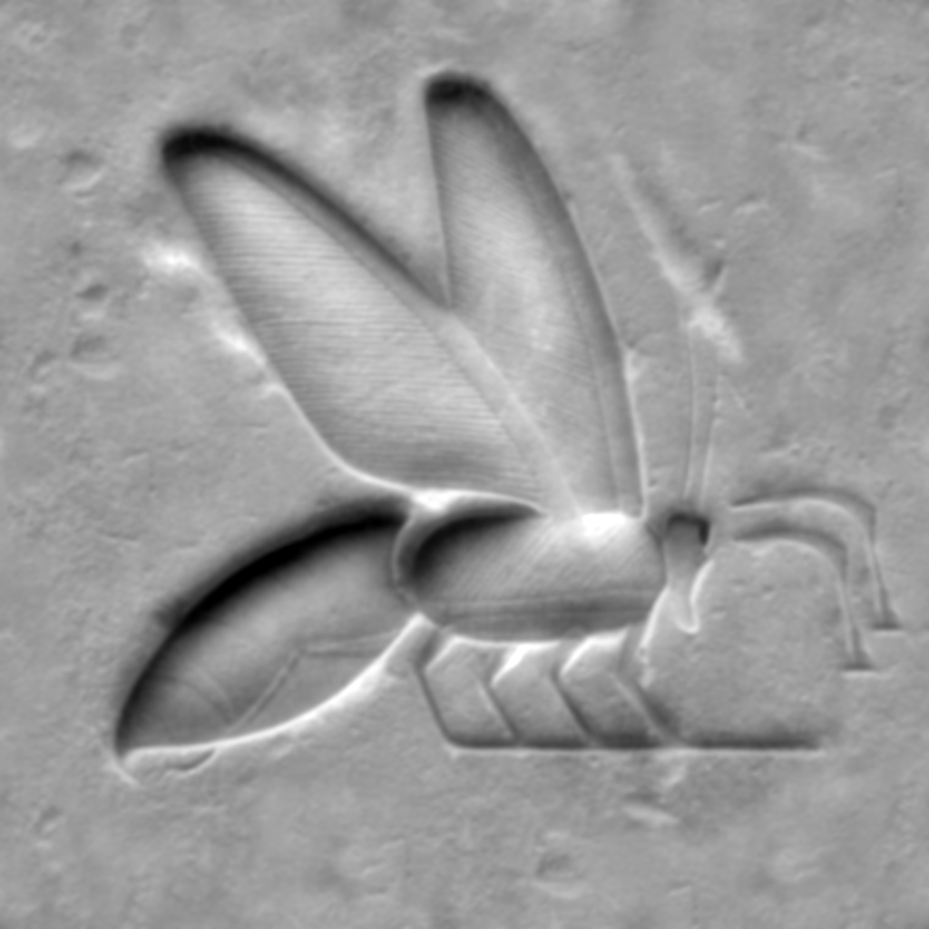

got image from here and made it tileable in PS
http://commons.wikimedia.org/wiki/File:AncientEgyptianRelief-BeeHieroglyph-ROM.png
Results in ShaderMap
note: resolution was lost in the posted normal map due to forum size limatations.
