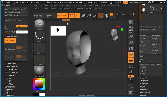

Hello
I USE ZB 2021.1.2.
Live Boolean open ,make Boolean mesh don’t working.
In the same folder Boolean it.don’t working.
Use VMware Workstation WIN10 TEST ,Can work.
USE my friend’s PC test , no problem ,Can work.
My friend’s pcdifferent only cpu.

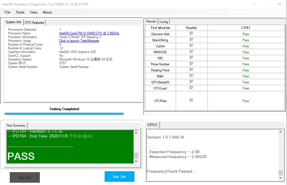

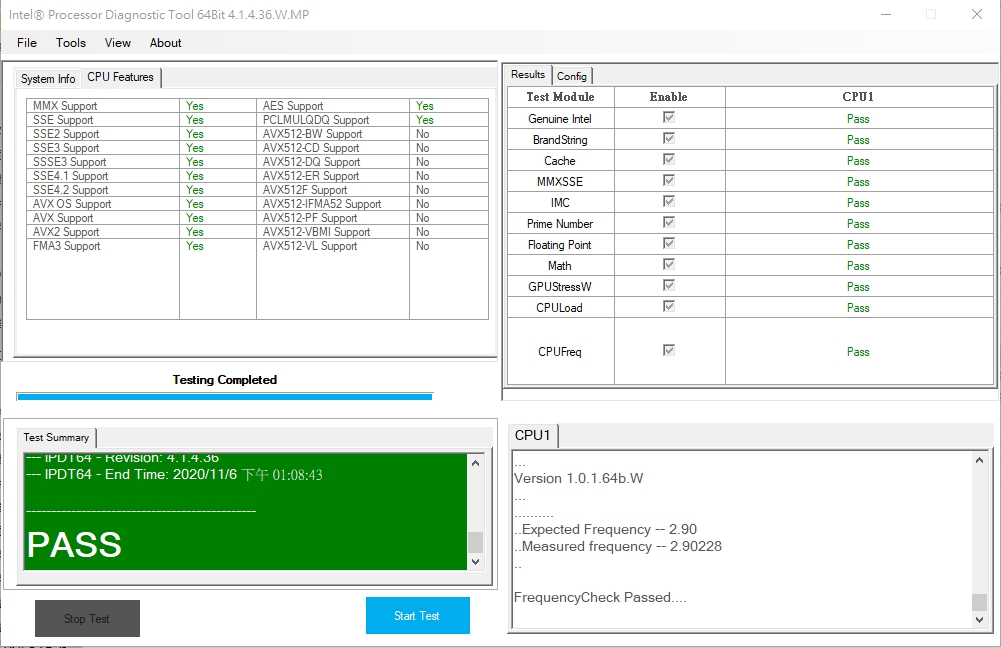

I use i5-10400, my friend’s i7-10700.
I use Intel CPU test tool (IPDT_Installer_4.1.4.36_64bit) test it ,ALL PASS.
How can I fix it?
