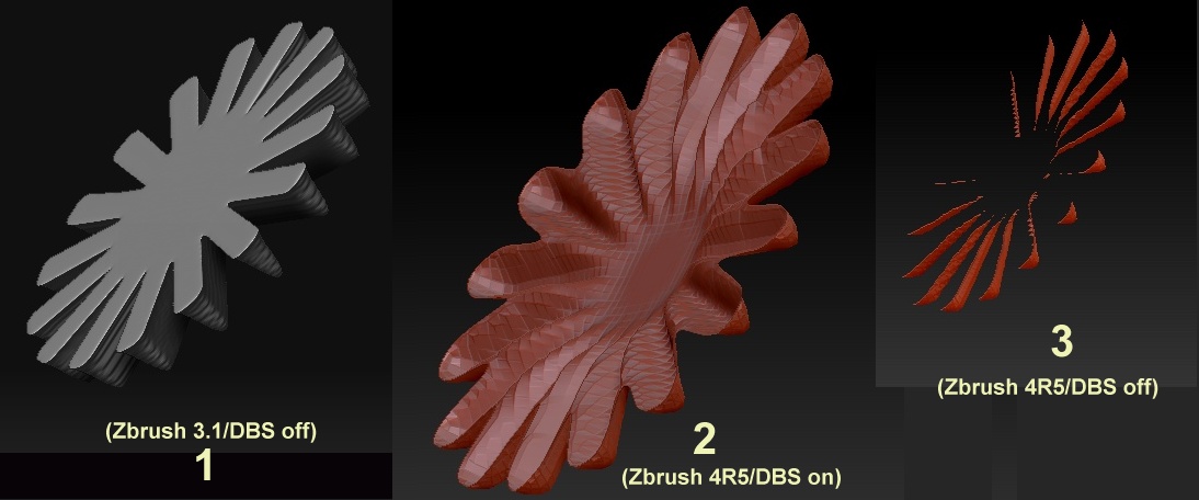

I’ve been struggling with an attempt to recreate a feature that existed way back in version 3-- the Make 3D – single sided but closed with a flat back. At some point (exactly when, I didn’t notice), when the doublesided option is off, the mesh was no longer closed and was just a single-sided mesh with an open back. I can see why this could be useful, but at the moment that’s not what I want and it is inconsistent with what the help message says the doublesided option will do.
In addition, I notice that as of 4R4, when doublesided is ON, you get a mirrored back, but now that I’ve upgraded to 4R5, the back is no longer mirrored, the object is closed but it would appear that each poly simply has a backface now, as the back looks like the inside of the mesh, not a mirror of it.
I also note that under some conditions the corners of the mesh are rounded-- I’m not sure what that’s about or why anyone would want that.
The behavior has definitely changed, but the help message for the doublesided option has not-- what am I missing here? Is this a bug or a feature? Is there another option in some other area that affects how this will behave? How DO I get a flat backface now, or is that possible with the tool anymore?
Attached are 3 examples, 1) Example of flat backface with Doublesided OFF on ZB3.1 2) example of doublesided ON on ZB4R5 (concave backface) , 3) example of doublesided OFF on ZB4R5 (no back at all)
A.
I haven’t really dug around the various settings yet, but a fall back would be creating what you have (double sided on or off, shouldn’t matter either way), translating it back a tad bit (to ensure it intersects the floor axis), use Mirror and Weld to mirror the back side, and if you want it flat then either clip/ transpose/flatten-deform to flatten it (every method seems to work fast and fine)

The Double Sided is in deed not correcting correct in R5. However for the time being you can do what Cryrid suggested until it’s fixed.
As a workaround if you have an earlier version in which double sided works you can make it double sided in that version then export tool, then import tool to 4.5 for further work using all those other new cool 4.5 features that do work.
