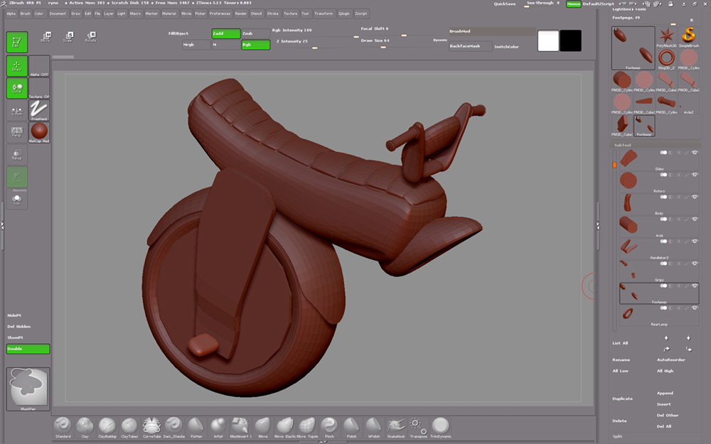

Hi all. I have a low poly (about 46k) hard surface model in ZBrush that suddenly became unresponsive. Whenever I try to even move the scene around or scroll down the subtools, ZBrush takes about 2 minutes to respond.
I have several other projects that are 12-18 million polys and they work fine. It’s just this one project won’t respond.

The undo history is gone when I open the project up days later Doug, you should see the no history in the screenshot. This project is a couple weeks old, I shelved it when the issue started.
I’ve pretty much decided this subtool is hogging it all up. Only 7000 polys but there is something wrong that is causing the issue. I tried to ZRemesher but ZRemesher crashes on that subtool. Then just a minute ago I dynameshed it successfully and that made it a little more responsive but not by much.

Thanks. Yes you could be on track there. ZRemesher crashing got me thinking along those same lines. Late last night I had a closer look at that subtool and some edge verts were pulled inside the geometry. So I used the trim brush to cut part of it away and then re-dynameshed. That resulted in much better responsiveness so I think the problem lay with the geo in that subtool.
To be on the safe side I will delete the subtool rather than risk it giving problems later on. I will make it again from scratch as it’s an easy one to make.
