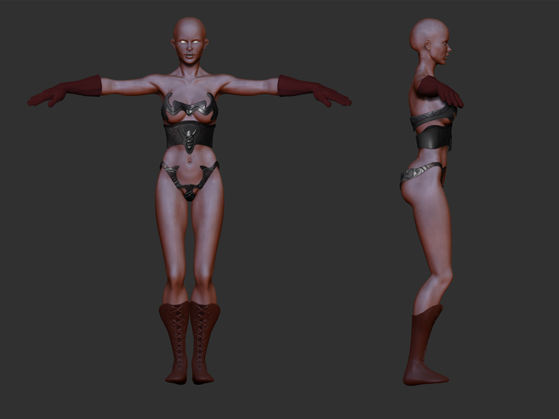

So ya I have hit the developmental brick wall as usual.
My plan was to sculpt high combine the mesh into 1 and reconstuct sub d to get a low to high model that I could pose in Zbrush.
1 small flaw in my plan. Once you combine the mesh into one. Anytime you hit the reconstruct sub d button the lights dim in the neighborhood, gun shots , sirens the whole bit and then the freeken CORE MEMORY ERROR MSG. So ya need to find a work around-seems to be that status quo. Back to being a techy I go as I hang up my artist apron and apply my pocket protector.

I posted it a couple times in skype a day ago. But it wasnt very far along. Im at the “pulling out my hair stage” with memory errors and every z quirk that the modeling gods like to throw at you at times. But I think I regained a little after I realize my workflow only goes so high in polys before you have to model the stuff as seperate parts. Then lower it until you see no lose of detail. Lazy mouse was used alot;) And so was inflate lol
Off with here hair!!!
Decided to do the hair in post production. It was slowing things down ALOT!!!
evil snake hook brush so sweet yet such a high cost;) Finished the boots and gloves. Now I’m going to try the combining and lowering the res again.

Critwise, the upper legs are too long now.

After the day was at its end I managed to figure out the limitations of My workflow.
I was able to fully re-construct sub-d an object that I made out of subtools that was combined into a single mesh.
And no it didnt have anything to do with the enable UV button of masks being off.
Those 2 things need to happen but also System Ram!
I have 4 gigs of ram and ya I had to lower all the subtools to a minium of 1 million polys. And the whole object to 4 million polys once its combined. Anything higher (believe me I tried lol) would not re-construct.
So heres a picture of the mesh reconstructed and combined.

So after a few days of wondering what was wrong I figured out that the scale was WAY WAY to large. Under the deformation toolbar theres a button that is the most magical thing in the world UNIFY.
After pushing this button like every problem I had went away. I can now POSE/ Lower sub-d/ and my memory errors are 0. Not one problem since.

Anyway heres where I’m at. After you pose you can add all sorts of detail with subtools. (AFTER YOU POSE!) is the best method.
So still placing details and fitting things right now.

Well I guess I can post what and how the workflow should go thus far. This way you don’t run into any issues. But the UNIFY button Fixed alot of the issues only because as you develop with subtools it seems like every subtool gets more and more scaled. The transpose tool started not even working for me.
  1. Make a model out of Zspheres of a external mesh from a 3rd party app usually the scarecrow position helps.
  2. Sculpt and detail the character try not got go above a 4million poly limit.
  3. Only use subtools for symetrical things. (shoes, gloves, eyes) as far as my armor goes I could have saved alot of time not worrying about it till after the model was posed. It was just in the way half the time.
  4. Once you are done delete lower on all sub tools and combine the mesh by cloneing each part and insert mesh. Remember (4million polys is all I’m recomending) unless you have a very beastly machine.
  5. Once you have them combined make sure all masks are cleared and Enable UV is on
  6. Polygroups /AutoGroup you model
  7. UNIFY scale button under deformation
  8. Lower Sub-Level by using the reconstruct -lower res button
  9. Make a new Layer !
    10.Store a morph target this will store your T-pose
  10. Pose
  11. Make whatever Non sym. Model on the character at this point using the topotools. (I have many many many videos on the topic on my site in my sig)
  12. This is the stage im at right Now.
    Hope that helps.
    Sorry I did not post a more detailed thing last post but Mostly I’m still working on a very non linear workflow still. Every person will have to develop his or her workflow differently depending on the 3rd party apps and such. But As long as you keep it in Zbrush with the above steps you will be fine.
