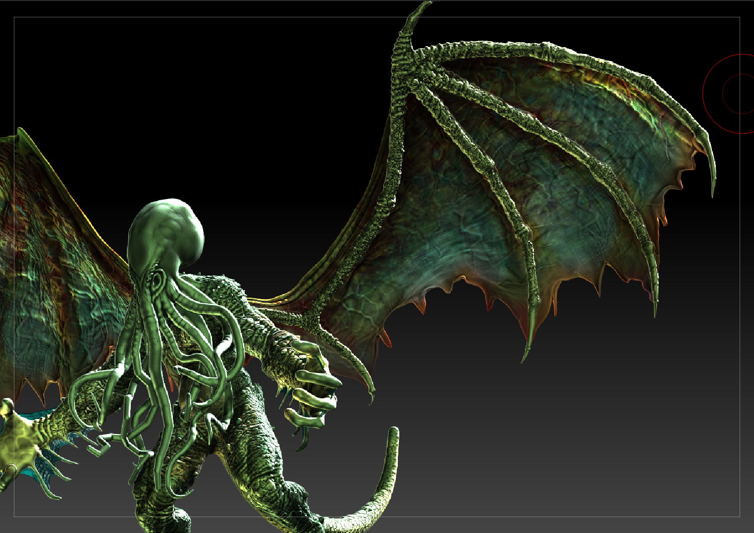

Hi, did you consider drawing the membranes in shadowbox, inside Zbrush?
That´s the way I´m doing Cthulhu´s wings / membranes. Standard sculpting for the bones and muscles of the wings. Shadowbox for drawing a thin and flat membrane, with the basic form (like a bat), holes and so on, and then adjusting it to the wing bones with the move brush and transpose.
Then, I start modeling on another subtool layer for the membranes, inflating veins, giving a soft fabric texture, etc. And another layer for the translucent polypaint.
I´m still working on it, so I cant show you an example yet (and this will be my first serious attempt in Zbrush)
Just a wip, (I don´t like the polypaint yet), but here you can see an example. Membranes drawn in shadowbox as a base form to work with.
Hope it helps you.

anyways thanks again and your Cthulhu looks great.
