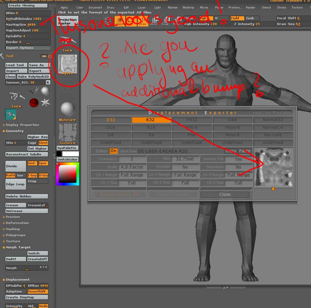

I noticed in your screen shot of the Displacement Exporter the quick code is:
DE-LBEK-EAEAEA-R32
whereas in post #28 you give it as:
DE-LBEL-EAEAEA-R32
Does this make any difference?

Yes you do;) One can see that you got some settings turned on plus you got an alpha loaded thus …
Try that: Turn off everything under TOOL/DISPLACEMENT (Mode must be off, Intensity too) and try again. You shouldnt use these settings when dealing with MD2 which can be found under plugins (unless you want to add an additional bump).

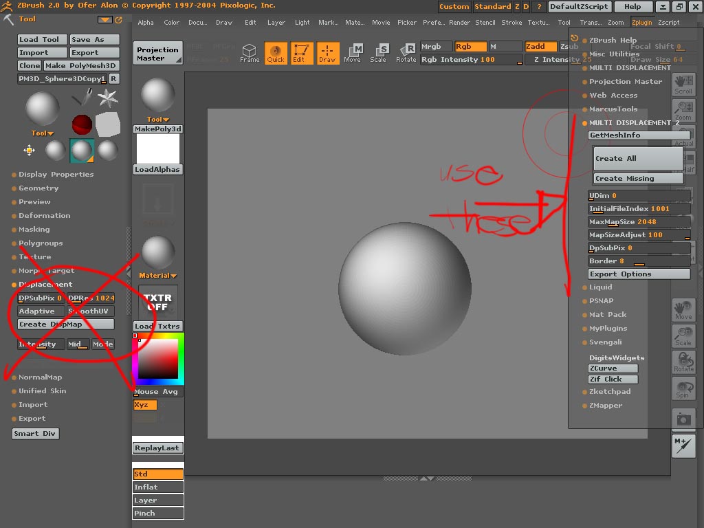

And Hosh, i think i see whats wrong, You are using the TOOL/Displacement instead of Plugins/MultiDisplacment 2, but at the same time try to export your map as 32 bit WITH the MD2 exporter. You should never ever use tool/displacement to generate you displacment maps, its obsolete.
Use Plugins/MD2 only. Im pretty sure thats the case, as you usually cant see the 32 Bit alpha in Zbrush itself (ZB2 cant handle them, its as simple), but on your pic one can see that there is an alpha. At the same time one can see the Tool/displacment panel rolled out, which you really shouldnt touch (for the purpose your after).
