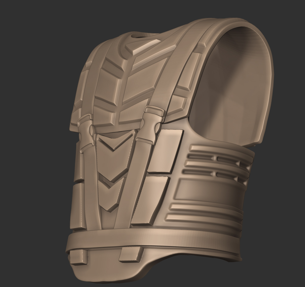

Looking for advice on how to sculpt this.
Hi, have used the new ZB4 tools to model the lower half of this armour. Liking the new clip and mask tools a lot. Anyway, problem is I need to chamfer the edges on the lower bit, to be more like the one on the top (which was modelled in LW). I can find a good brush to cut into the raised bits to make them a little less pronounced, but cant find a good one to cut the sides at a slight angle. (I can do this with the armour unwraped and flat.

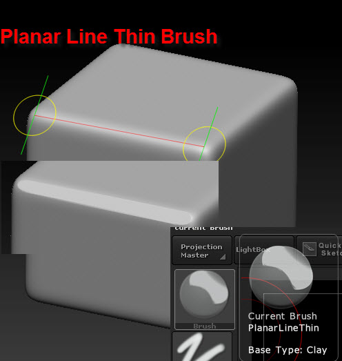

Planar Line Thin Brush will do the job!
[Planar Line Thin Brush.jpg](javascript:zb_insimg(‘214076’,‘Planar%20Line%20Thin%20Brush.jpg’,1,0))

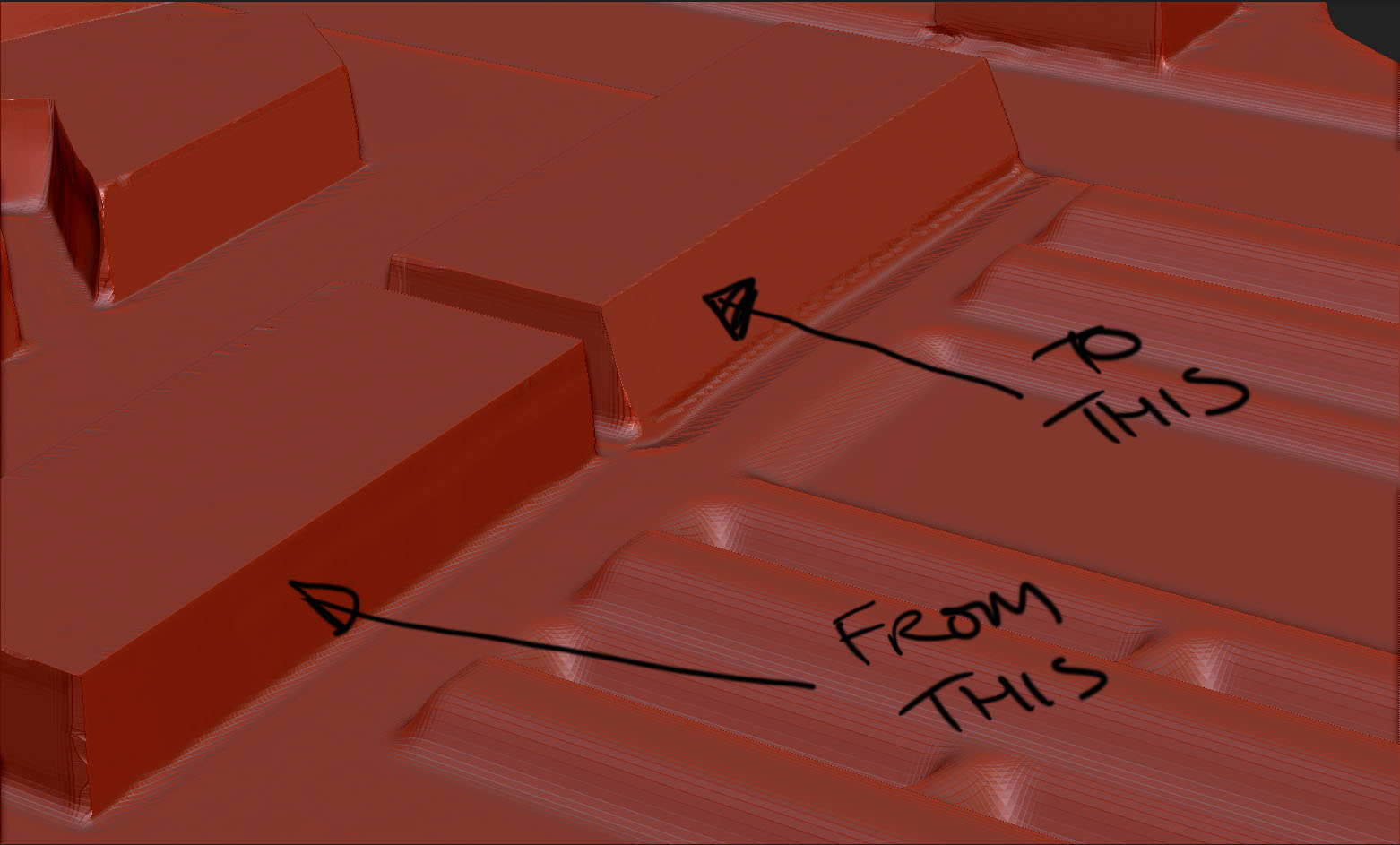

Cheers, I should have been more specific. I didn’t really mean chamfer (which your answer is perfect for), I mean like shown in the attached image, but I want to do that will all the edges in a way that is controlable. With the planer line, it is really hit and miss to get the angle right.

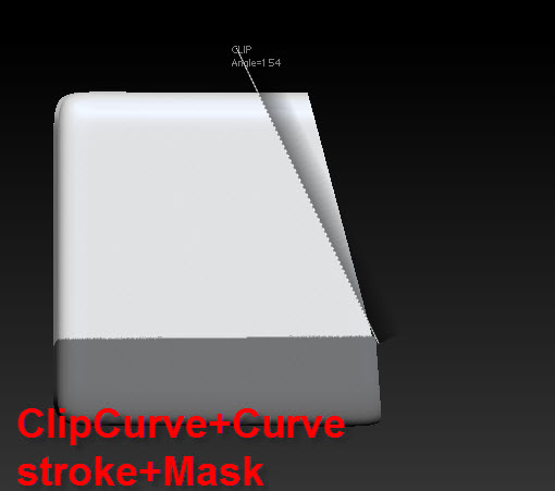

[clip curveplus curve stroke._1.jpg](javascript:zb_insimg(‘214310’,‘clip%20curveplus%20curve%20stroke._1.jpg’,1,0))
Yeh cheers Andre, I had originally tried it that way. Problem is that all of these bits that I want to cut are at difficult to line up the way you have shown, so it’s really easy to have a cut that is off along the length of the cut. What would be ideal is a brush, like the planer line, but that you can have more control of the cut angle.
Ok the other way could be( i understand your point: i agree is dificult) that you make polygroups and the isolated the mesh you want to rework? just try it, hope this help:+1:

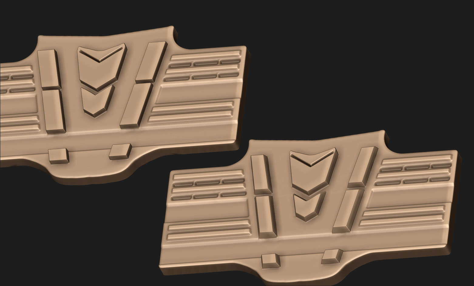

That did it thanks. TrimFront was exactly what I was looking for.
Here are the results. Before on the left, after on the right. Still a little bit of tidying to do.
aja,you get it!!!:+1:
