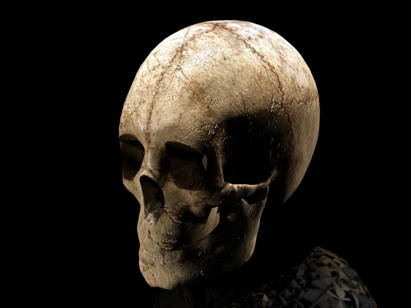

Okay, I had a couple free hours to tweak a test of a realistic 3D bone.
Please, bear in mind that the model is crappy ( I found nothing but this one, no luck ! ) and that everything could be bettered ( UV’s unwrap, texture and lightning ). Tim’s advices were excellent, but in this case it is just a quick and humble SSS / texture test.
And I thought that, starting with a low-quality skull and trying to make it realistic anyway could be a good challenge. :slight_smile:
All the maps were painted with ZBrush. Projection Master is really handy for these kind of things. But I guess Maya’s Hypershade could be more appropriate than Max’s material Editor to go farther in the SSS tweaking.

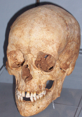

So, here are two pics, my 3D skull and a reference photo of a real human skull. If you guys think it could be useful to you, I’ll post my SSS setup and one or two tips.
Monstermaker, something I didn’t mention in my previous post was the specular factor, the way things are shining. Ask yourself what, in 3D, is the difference between plastic and metallic appearances. And then, look at you waxy skull. :wink:
