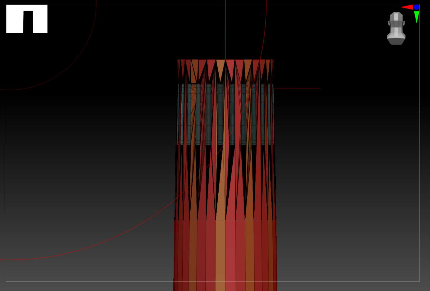

Hello,
I’m having issues remeshing the product of a live boolean operation, which resulted in a pretty nasty mesh.
See the image attached.
Zremesher throws an error after trying for a while. Is there anything I can do with a mesh like this to try to get a cleaner mesh?
Thanks2020-09-09_22h16_16

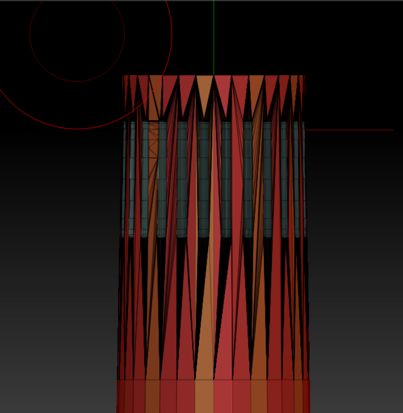

Hello @Ouranos
Your mesh looks odd, beyond the obvious. There appears to be some sort of overlapped geometry visible on the interior of your mesh. Note that Zremesher does not fuse or weld together any polygons that are not already fused and welded. Also make certain your mesh is fully un-hidden when Zremeshing, otherwise ZRemesher will only partially re-mesh.

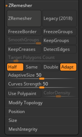

  3. A complete, uncropped screenshot of the entire ZBrush interface at the time of ZRemeshing, with the ZRemesher menu open and all settings visible.

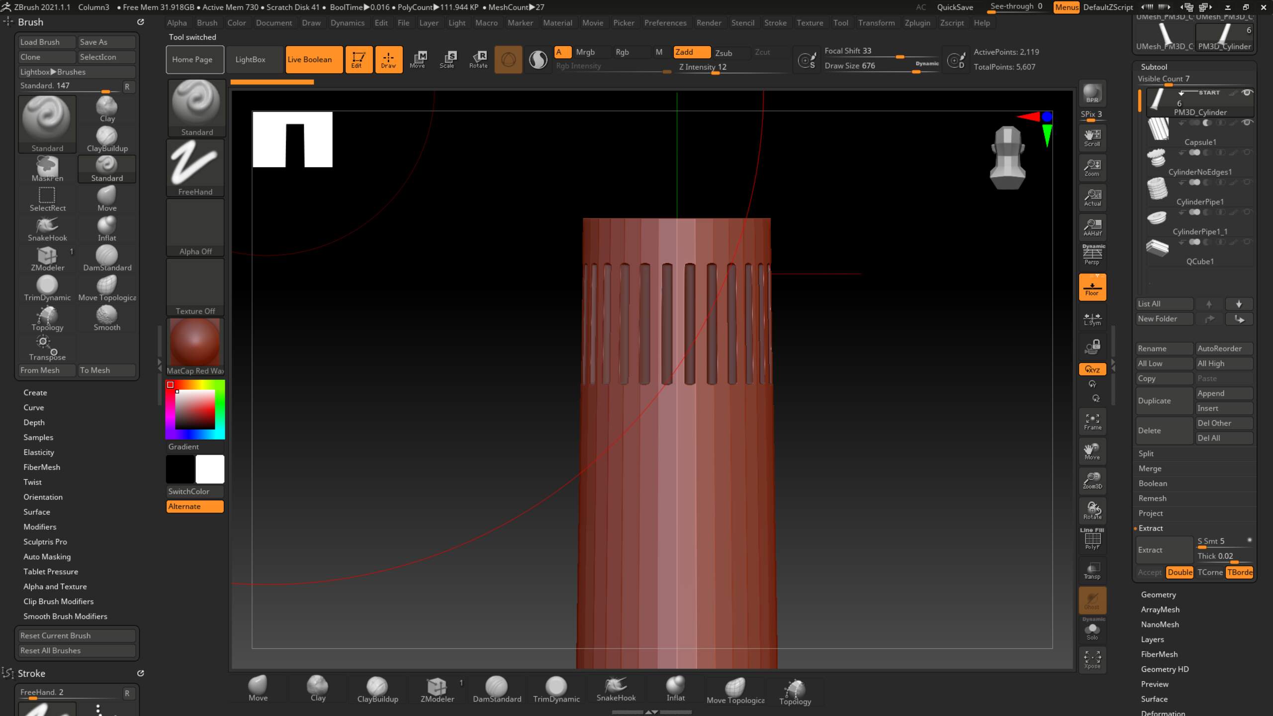

Thanks Spyndel!
Here are some images, let me know if this makes any sense.

I’m still not completely sure what Im looking at. :thinking: If you are in fact ZRemeshing the resulting merged UMesh from your boolean operation, it should look something like this at your settings:
zrmsh
Based on the information I have, I can only assume your mesh is faulty in some way.
Also be aware that ZRemesher is not effective with extremely low polycounts. There is no way you’ll get a “half” result from a mesh that is already that low poly to begin with. It should not have produced the result you’re showing here, however.
I recommend subdividing your mesh to smooth it, unless you want that low poly faceted look. Then run your mesh through Dynamesh to clean it up, close any gaps, and eliminate overlapped geometry. ZRemesh the resulting, higher resolution mesh.
