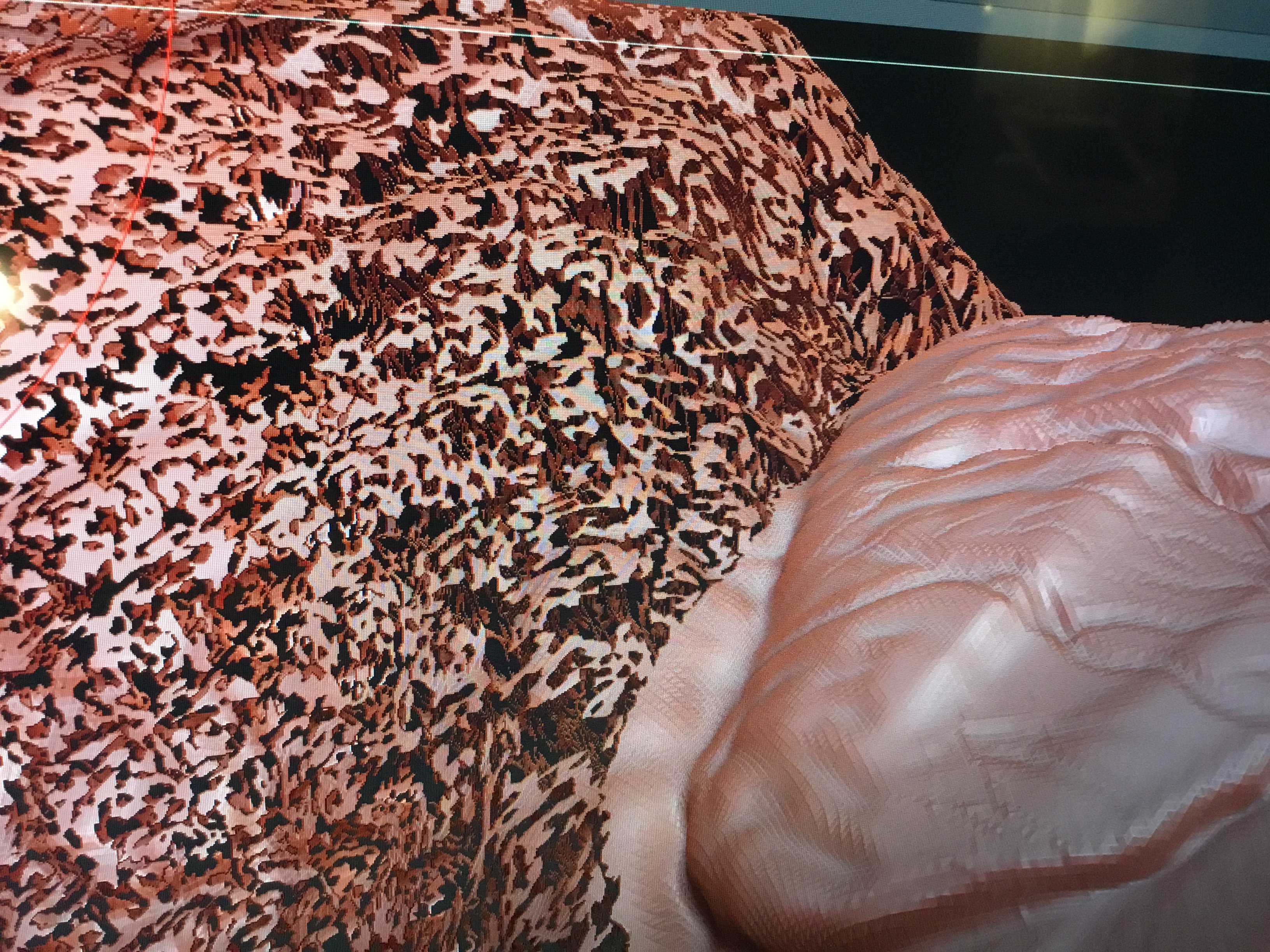

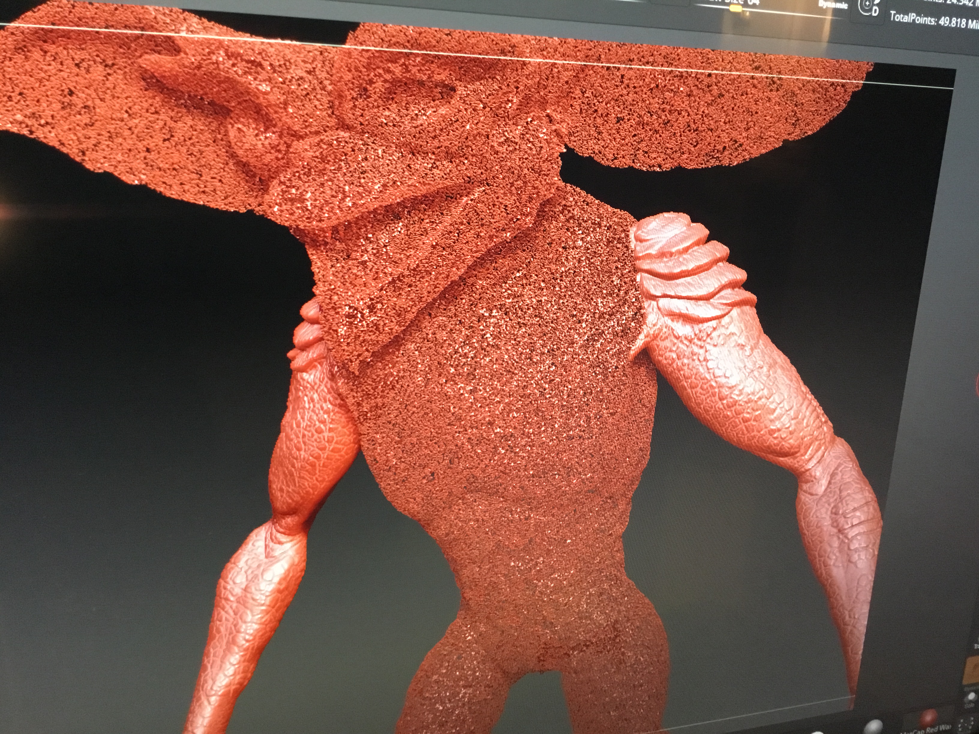

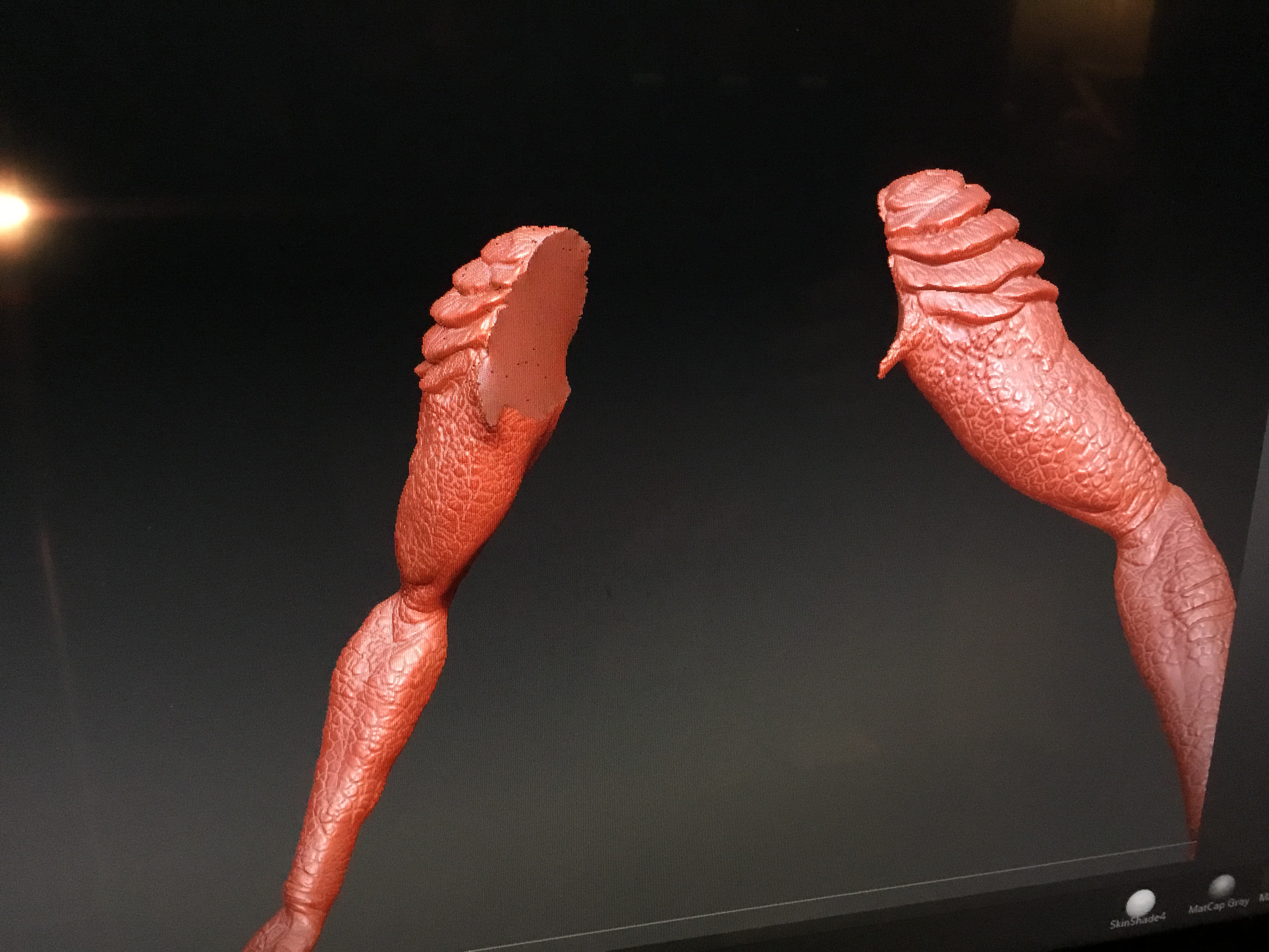

I ‘duplicate’ my master subtool of a character, then seperate the ‘duplicate’ into sections using the looptool > delete hidden > close holes, (to remove the arms, I do not modify the model in anyway, other than this).

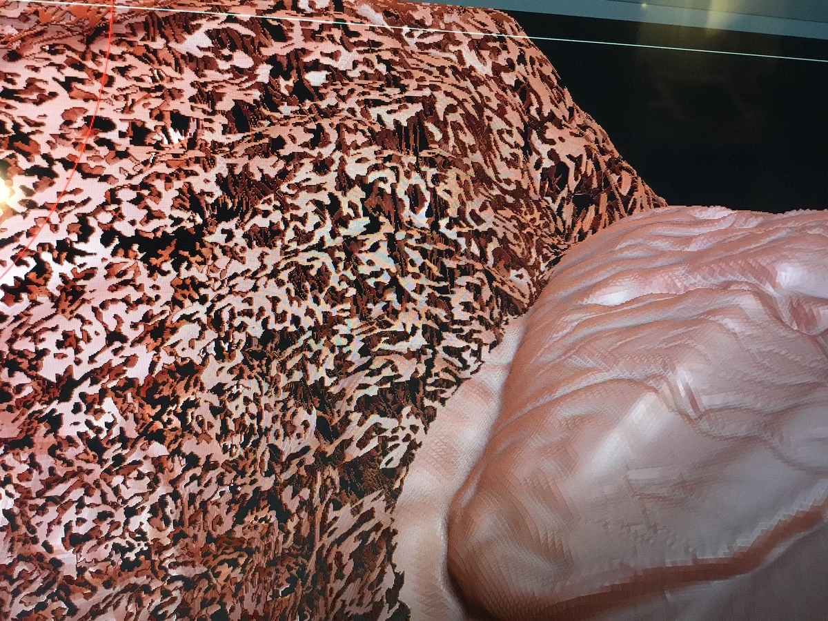

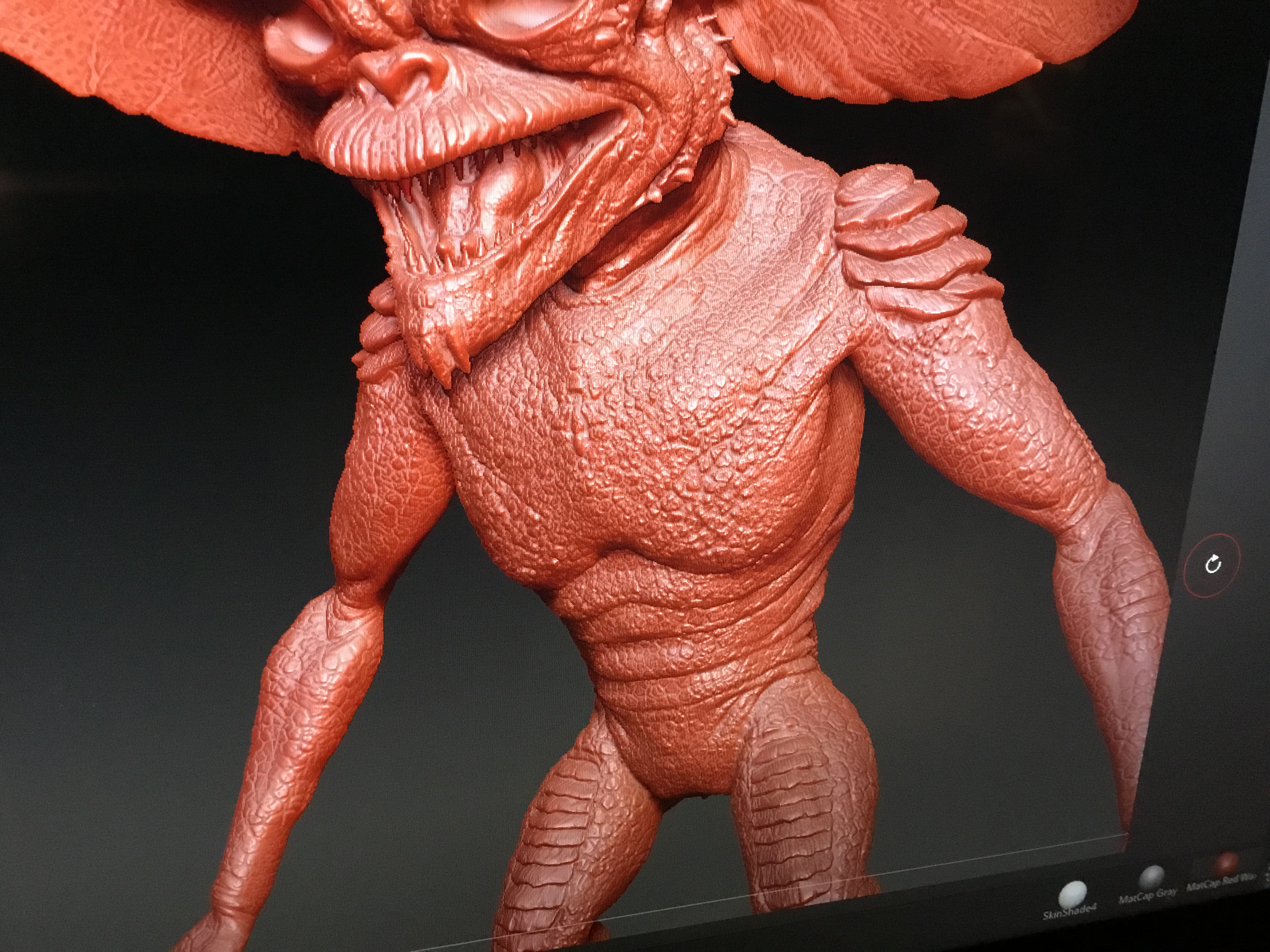

I then complete a ‘live boolean’ operation, the live render shows up absolutly fine and removes the object. I can fully rotate it and everything looks perfectly fine, however when I click I ‘make boolean mesh’ and ‘append’ the item, it comes through with a strange noise/camoflage surface layer that is not there previously?, the models are Identical in every way, its an exact duplicate???

I’m not exactly sure what you’re trying to do from your description. It would be helpful to see a screenshot showing the exact mesh youre trying to use to subtract from another and how it is positioned,without live boolean active so we can actually see the mesh. It would also be helpful to understand exactly what you want to do without worrying about the “how”. If all you want to do is isolate the arms from the body, there are a number of simple ways to do that.
I could be mistaken here, but it looks to me like maybe you are trying to subtract a portion of a mesh, with a duplicate of that mesh. The potential problem with that is that the subtraction mesh may not completely cover the target mesh. It may occupy mostly the same space, but there may not be enough overlap there to keep ZBrush from getting confused about what should be cut and what should stay.
Make sure any Live Boolean mesh completely envelops the mesh you want to cut away.
