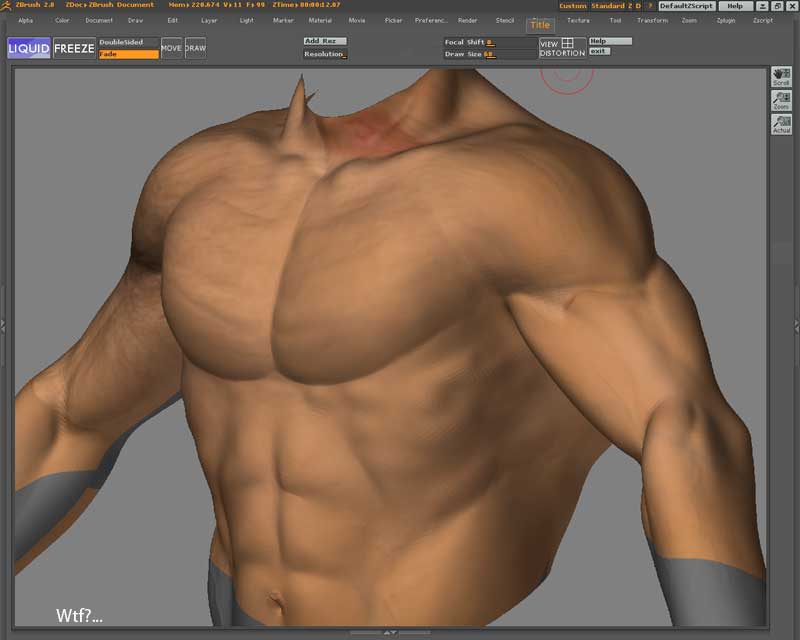

Ummm, i think that maybe i´m the only one having errors with this zplugin.
Ok, so i load a model with some subdivs, then import my texture and flip vertical. Place it on the canvas and hit L.
It all seems to go well, i do some small modifications moving the texture and when happy i hit L again. It drops and everything seems ok. Then i realize that i have double side texture. Try to undo, but it does not work. Then, i change my texture back to the original and hit L again.
Now, the texture on the object inside the Liquid seems to be wrong as hell. Nothing is in place like if the projection had failed totally. I hit Exit and the texture on my object is correct, but it seems that if Liquid has a temp buffer, it is not cleared when entering a second time.

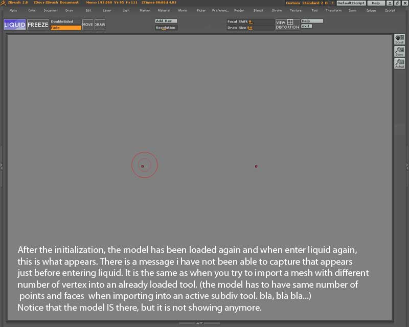

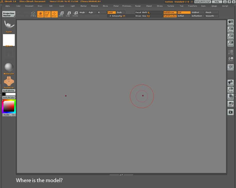

Even more, after some frustrating tries, i do a Init Zbrush to start again. I load my model, my texture and hit L. Then while the entering progress, a message appears during a second or two saying something like “swith to the correct subdiv level…” and when Liquid enters, my model has dissapeared. If i exit, the model still is dissapeared, and the only way to get a mesh back to the canvas is to reset zbrush.
I have experienced some more strange behaviors with this, but all of them seem to start when entering a second time on Liquid, since the first time it works ok.
Am i doing something wrong? Is there anyone with similar problems? I´m really excited about this plugin, but as it is working for me right now, it is impossible to use.

I´m using the version downloaded from this thread, but really, this seems like a bug or something. I have tried to make it work on other machines and still the same thing. The main problem is that it seems that when you enter the liquid for the second time, the 3d plane seems to be flipped backwards. I cannot find any explanation for this strange behavior
also, i have always exited the plugin with the exit button.

just wanted to chime in to say, first, that this is a tremendous plug. when it works, it works beautifully. i love it. unfortunately i seem to be having the same problem as jhotun. works fine the first time (create a ztool, drop into edit mode, create a texture, PM a few brush strokes, pick up out of PM, then drop into liquid, edit, pick up out of liquid). next time i drop into liquid, my model appears mostly black. by moving my cursor outside the document bounds and rotating the plane i can reorient it so that it looks correct again. but when i try smudging the texture again it seems unstable. the texture moves a bit before and after each “smudge”. can’t quite figure out whats happening…if you have any questions i’ll do my best to answer.
-matt

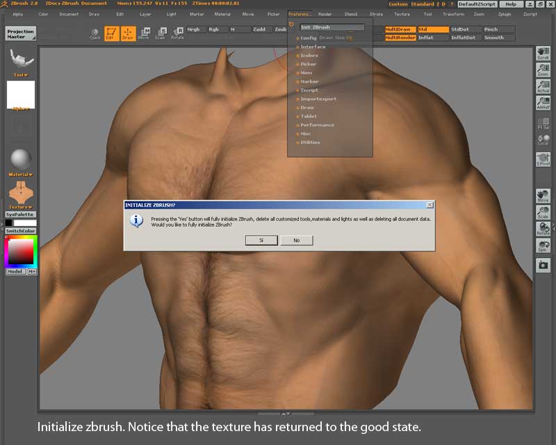

Instead of that, i have done some screenshots of the problem. I hope this can help.
So, the problem seems to be when entering Liquid for a second time. Initialize does not seem to clear everything on the backstage.
Oh, i forgot to say that if i click on the Move or Draw button inside liquid… they dissapear
Just like when you ctrl+click on any button. Veeery strange.
I have a lot of job to do from now until sunday, so i think i will not be able to try to record the zscript for now, but as soon as i can i´ll try to record it.
Later
EDIT: Ryan, i did the MRGB and Zadd thing. Yeah, the model draws correctly without the need to restart zb, but when entering liquid, it is still invisible.
Jhotun and Matt,
Until Ryan has a chance to look at the code here is something you might try:
1.Start ZBrush and use the Tool>Load Tool button to locate and load the LiquidPlane.ZTL from the ZStartup/ZPlugs/liquidData folder.
2.Immediately press the Tool>Export>Export button to export the tool. Save it as LiquidPlane.OBJ to the ZStartup/ZPlugs/liquidData folder, clicking Yes to overwrite the existing file.
Now you can test Liquid to see how you get on. Be sure NOT to Initialize ZBrush during a session when you are using Liquid because clearing the Tool palette will cause the plugin to malfunction.
HTH,
hmm…so that totally worked. thanks, marcus!
