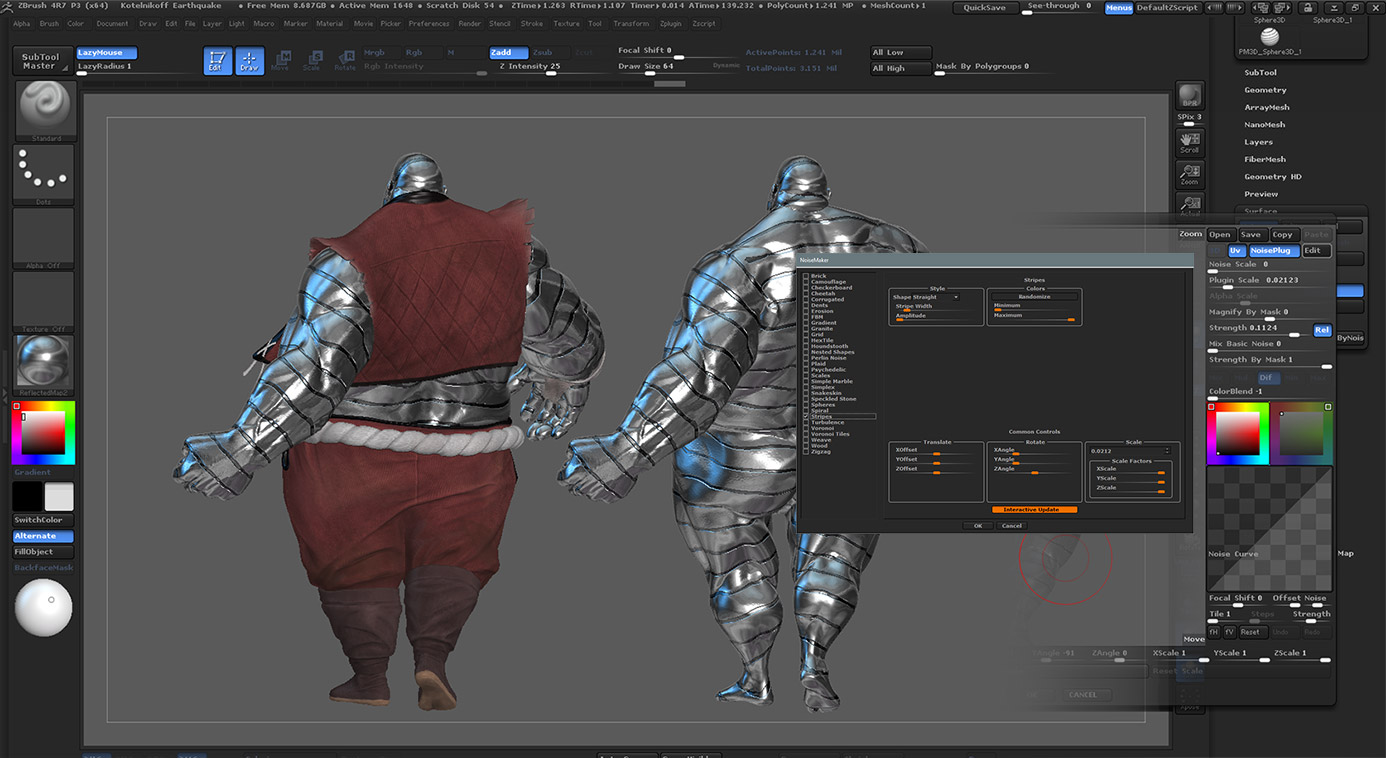

I did a very quick test using the “Stripes” pattern, and I think it seems promising enough to warrant some exploration. For a more complex shape like a human, you’ll probably want to have it driven by UVs. The trick would be keeping them as proportional as possible while sharing the same directional alignment, with your seems keeping the pattern and flow in mind.
Note: A similar effect can also be achieved with displacement maps, although any revisions would require you to change the the displacement texture or UVs rather than surface noise sliders.

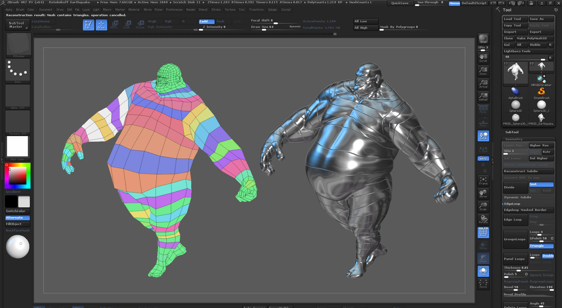

Alternatively if you don’t expect there will be heavy revisions and you’re comfortable altering the geometry itself, you could attempt to turn your edgeloops into individual polygroups and then use Panel Loops.
