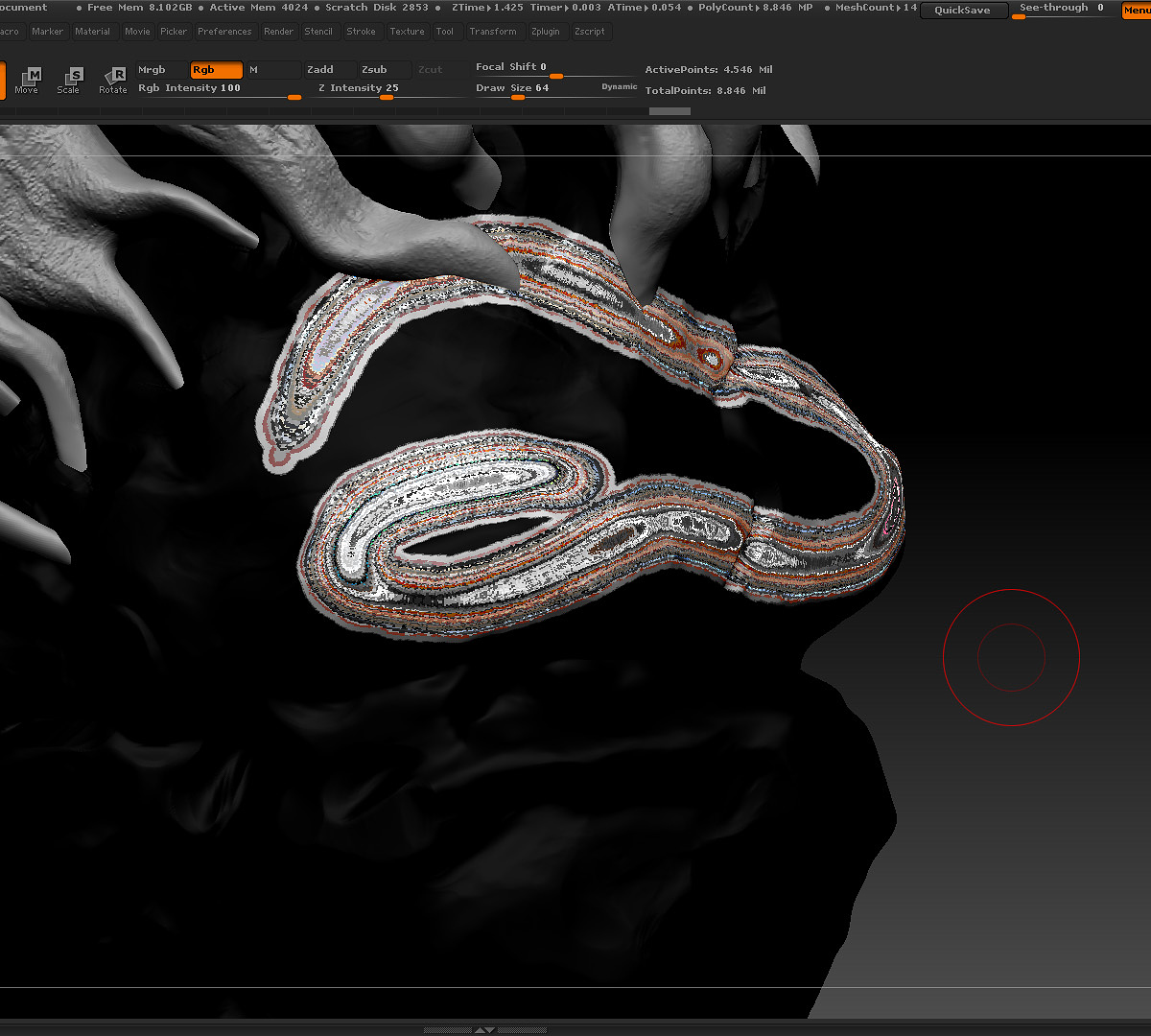

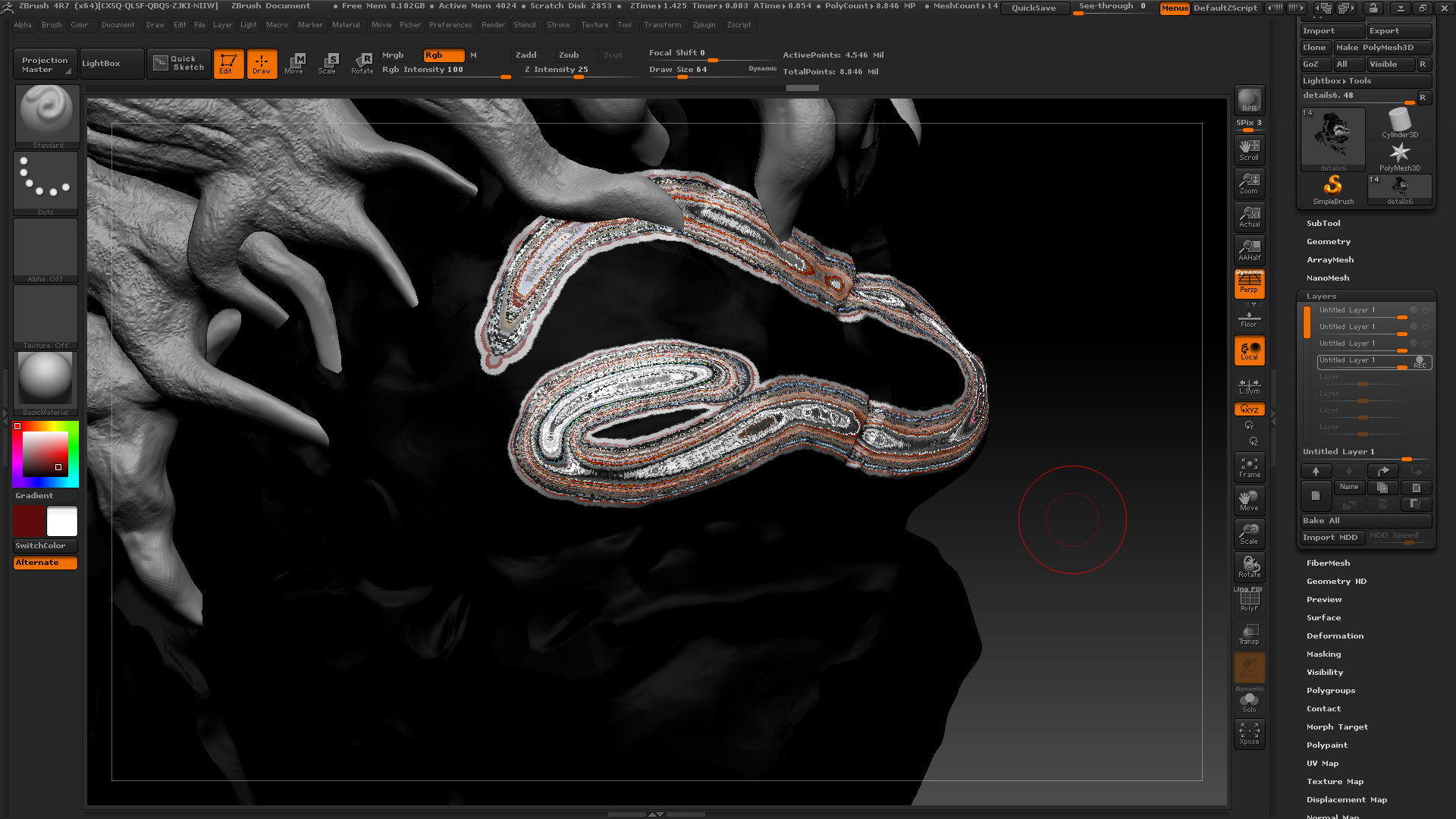

Now what if you actually want to polypaint? I try to fill it with white but it’s just giving me a funky “glitch” color (as seen in the image). Am I doomed to not being able to polypaint on this particular tool?
hej System did you somehow solve this problem ? IDK what to do … same here . pitch black or weird blackgrey . cant paint materials or color using layers. i also feel doomed
YOu need to go to Subtool and clik on the brush icon to deactivated

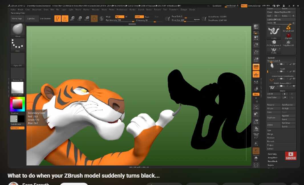

check also this
