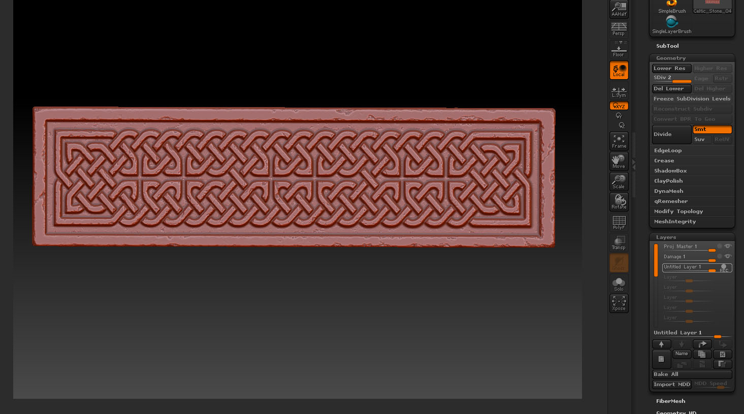

Hiyo,
I’ve got a peculiar issue occurring when trying to use layers in a sculpting tutorial. In the pics, there are three layers, the bottom one is supposed to mask out the damage of the second (middle) layer, but as soon as the layer stops recording, all the damage reappears. If I add layers, the same thing occurs … and if I delete the bottom layer, all the damage disappears.
The intention id to restart from the beginning, but I thought to ask in case there’s a fundamental lesson that needs to be learned here. Thanks much and happy holidays.
~CG

Thanks a bunch Doug, but unfortunately the procedure outlined in the link isn’t addressing what’s happening with my layers. There’s some kind of wonkiness occurring where the bottom layer somehow adopts info from the other layers. It’ll look right for a moment, but the moment the record button is turned off, it goes the state shown in the ‘After’ jpg provided in my initial address. Thanks for the link though.
~CG
