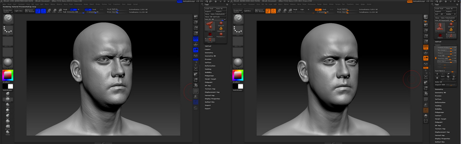

Unfortunately that does not solve the problem :cry: I did as you suggested but the layers don't work how they should, they are either no existent when turned on or do weird distorted things. Are you guys aware of a compatibility issue with .ztl layers between ZB 3.5 and ZB 4.0?
1st Image- ZBrush 3.5 R3. All layers on as should be
2nd Image - ZBrush 4.0. All layers turned on after loading. Not working.
