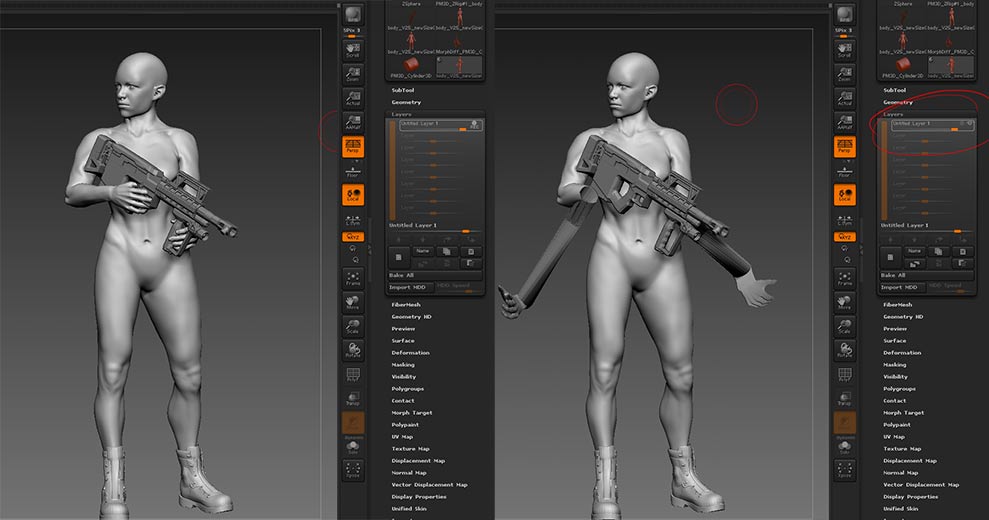

After hours of grueling problems with the transpose master, I decided to use the transpose brush instead. I wanted to be able to go back and fourth to tpose to keep the symetry; so I created a layer.
A few hours later, everything looks nice. I turn of the rec on the layer, and it explodes. Or rather the hands seem to want to go another direction.
I got the same problem while using the transpose master with the layer option turned on. So it must be a problem with the layers. Or? Has anyone but me experienced this problem?
The basemesh seems fine, no double edges, no inverted polygons or anything like that.
Help plz

Not giving up I tried to scale down al the subtools by using export settings and then appending them again to a new tool. Then I made a new pose on a new layer. This seems to do the trick, but now when I don’t have the problems with the hands moving I get the problem with the noise that they bring up in the thread that you linked me… Maybe I scaled it down to much and that’s why I get this strange noise artefacts?
