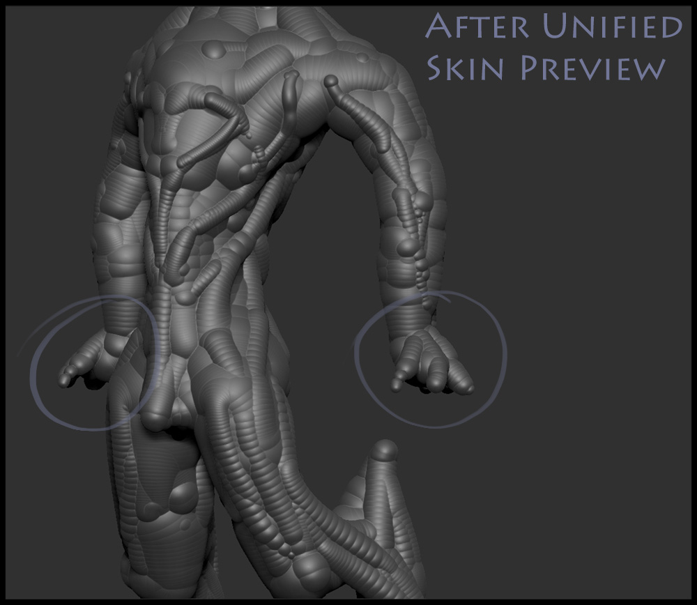

Heya guys,
Normally I wouldn’t first run to the forums for help, but I’ve searched high and low, on the forums, and on the Zbrush wiki, experimenting by myself, but I’m having some problems (In fact, I had it in R3.5, was hoping zbrush 4 would “solve” this).
I’m well aware that one way to keep the zsphere/armature volume is to go via adaptive skinning, but more often that not, there are errors in the end result. Unified skinning retains most of the detail of what I want in my zsketch, except the zsphere volume is lost via unified skinning.
I’ve read here and here about how to do it, but I’ve tried following the instructions, but I am still very new at this. I’ve tried making an adaptive preview, then remeshing, but the zbrush harps on about no polygons or somesuch. There’s the old adage of the experienced and in-experienced soldier, that the former requires few orders, whilst the latter requires a substantial amount to get the job done. I’m the latter, and in this case, can anyone help me with my conundrum?
Thanks guys, I am REALLY itching to get to sculpting, but I’m stuck on this bit =(.
Thanks in advance.
Which version of ZBrush are you using? Please post screenshots so we can better understand the problem.
Thanks for the reply, if I don’t respond after this reply, it’s probably because I’ve fallen asleep from sleep deprivation (Been up all night trying to work this out, searching forums, googling, reading the wiki, etc - it;s 4:10am in Hong Kong where I am).
Anyway, I am using Zbrush 4, I was hoping this “problem” would be resolved in 4, seems like that’s not the case.
Anyway, here’s 2 before and after pictures when using unified skin.

Extra Dimensional posted a very good explanation (thanks:)) and looking at you images, all is exactly they way it should be.
The unified skin will only skin the sketch ZSpheres, not the armature ZSpheres. if you you are ‘missing’ volume in the fingers then it is because you do not have sketch ZSpheres in that area.
If this is not what you are asking about then please post again and include more images demonstrating the problem.

I already know the difference between Unified and Adaptive skinning, but essentially what I am trying to find out is if it’s possible to use unified skinning BUT keep the ZSphere data, without having to ZSketch over the ZSpheres.
If it’s not possible, what would you recommend? Are there any alternative workflows to keep the highly detailed ZSketches?
