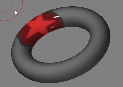

I did a ring, I converted it in a polymesh, in edit mode: I did a mask (a star shape), I active my project master, and I can paint out of my mask!

It does not right … or I skiped any important step?
I have my polymesh, I mask it, I open my project master (color and material, double side and fade are active), I drop it… I use a ‘Simple brush’ with ‘mrgb’ active and not zadd or zsub… I paint with a different color and material… I pick up… and nothing!.. my new material and shape get out of my mask, paint in and out side of my mask!
what I do wrong?
and thanks you all guys!

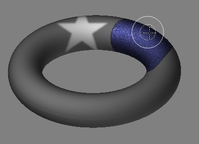

this image is tooked after I did pick up

Are you using a polymesh instead of a primitive? The parametric objects take masking into consideration when using Projection Master. Polymesh objects do not. So if your model is a polymesh, then the best suggestion is as Ryan said – use a stencil instead of a mask. Be sure to turn the stencil off before you pick the model up again.

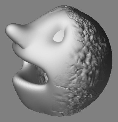

I have this case
I used a ‘inflat’ 3 times, now I want work JUST within my mask! with Projection Master!
Can I do that?
Thanks!
