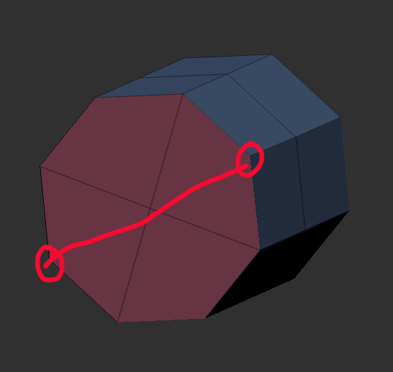

I have a QCylinder (2x2x2).
Is it possible to join the two vertices circled in red with new edges?
Thank You.
Thank You.
Hi @dd419
There are a few different ways to go here. But since you want to keep the existing edges, I think the easiest would be to use Zmodeler> Point> Bridge> Two points, and connect the target points on the outside to the point at the center.
This is assuming you want the points connected at the center. If you actually want the resulting edge to intersect slightly off center the way it is presented in the picture, there are other ways to go. Let me know if that is the case.
Brilliant. Worked perfectly.
Thank You very much for your help.
Yes, I want the points connected at the centre. (I need to learn how to draw straight lines in Photoshop
Thanks again - much appreciated.
