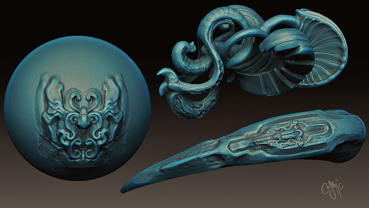

practicing …
practicing all day and all night
here are some recent studies

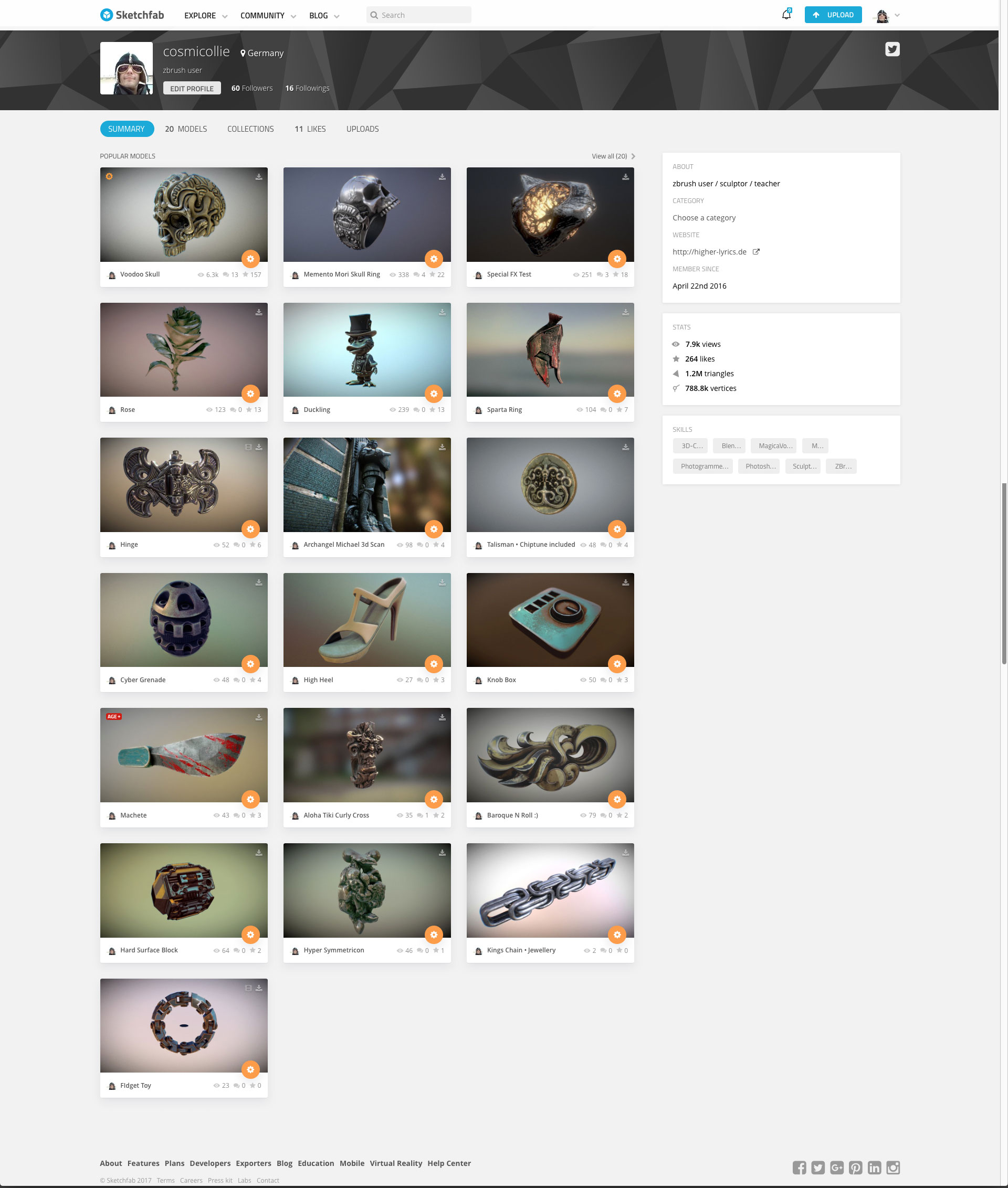

Hello,
i am experimenting with realtime / pbr and put up some of my models
on the sketchfab website. this is pure fun.
maybe you want to take a look at them.
I know it is not the main focus for pixologic. But it would be so cool to have
the ability to upload own models here on Zbrushcentral an see them in
realtime with WebGl or similar.
Kind regards & cu soon
Ollie

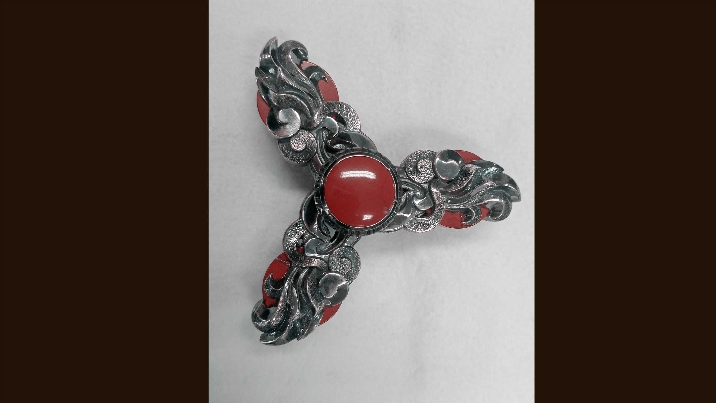

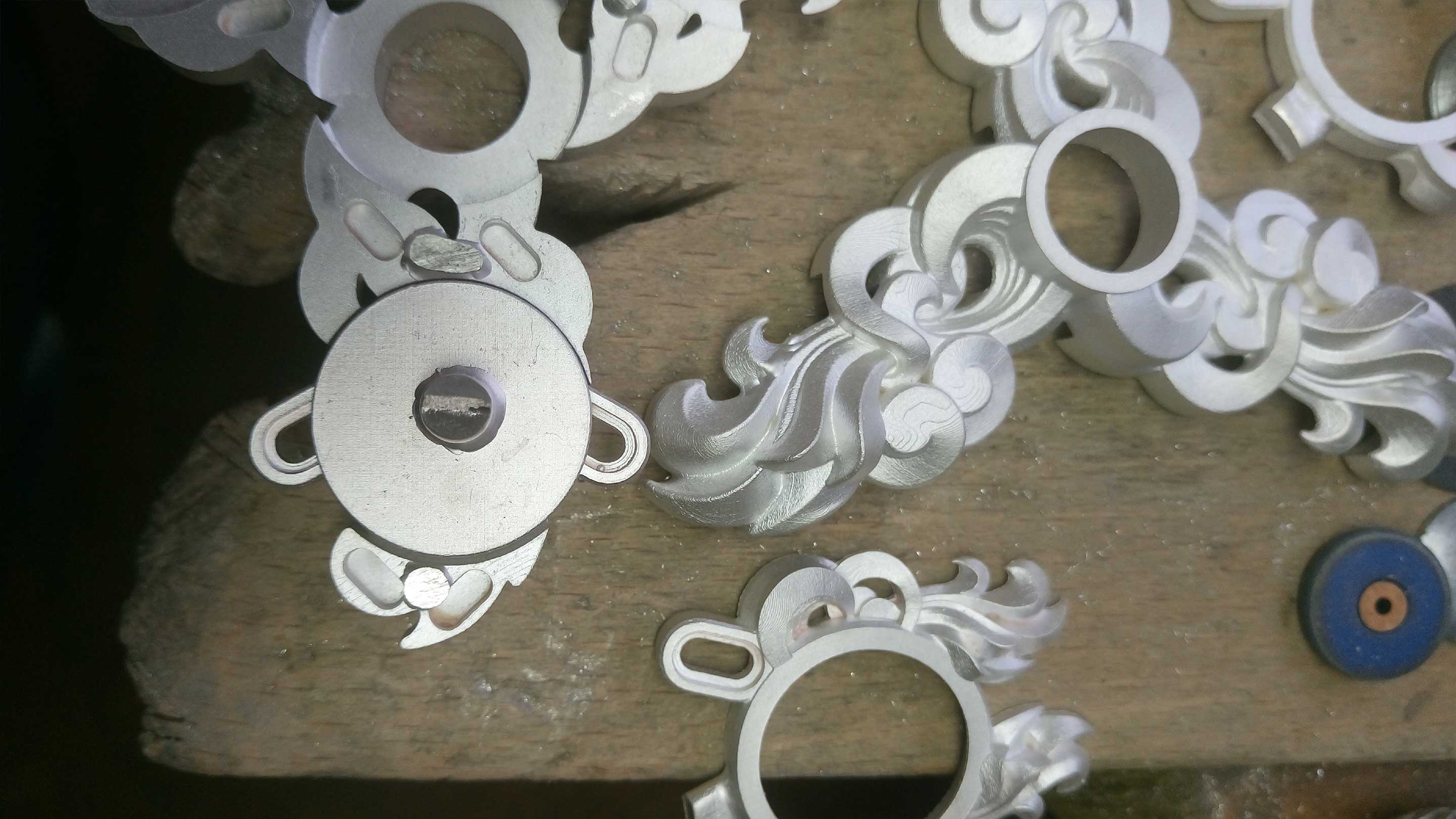

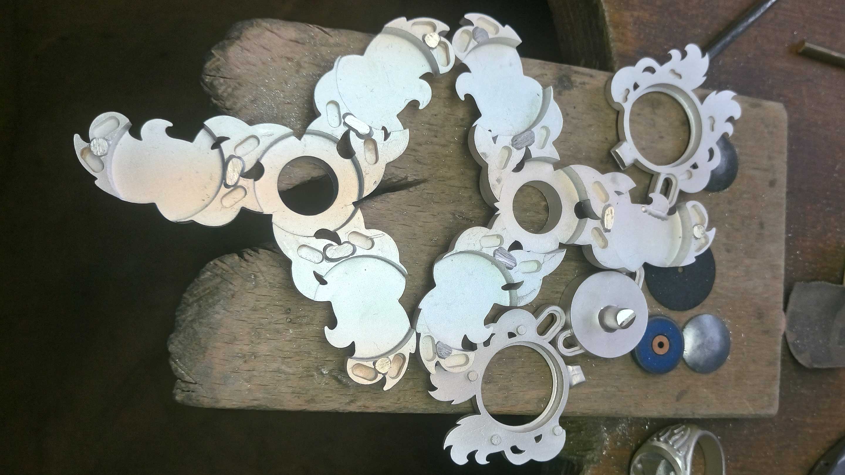

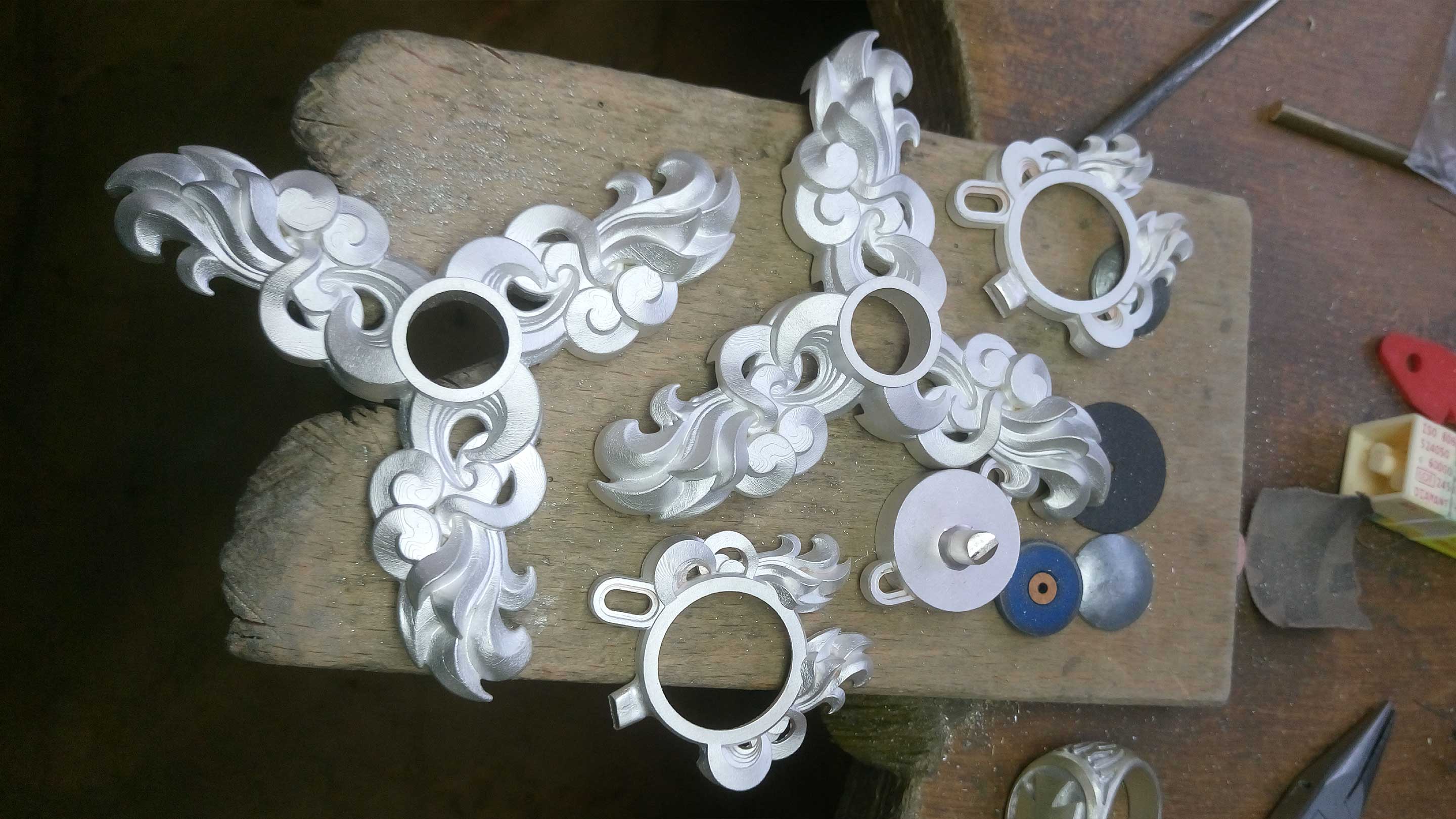

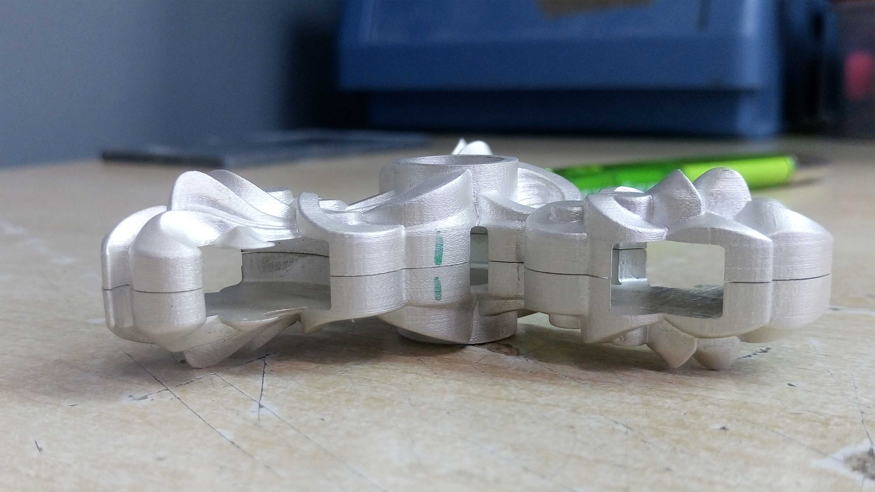

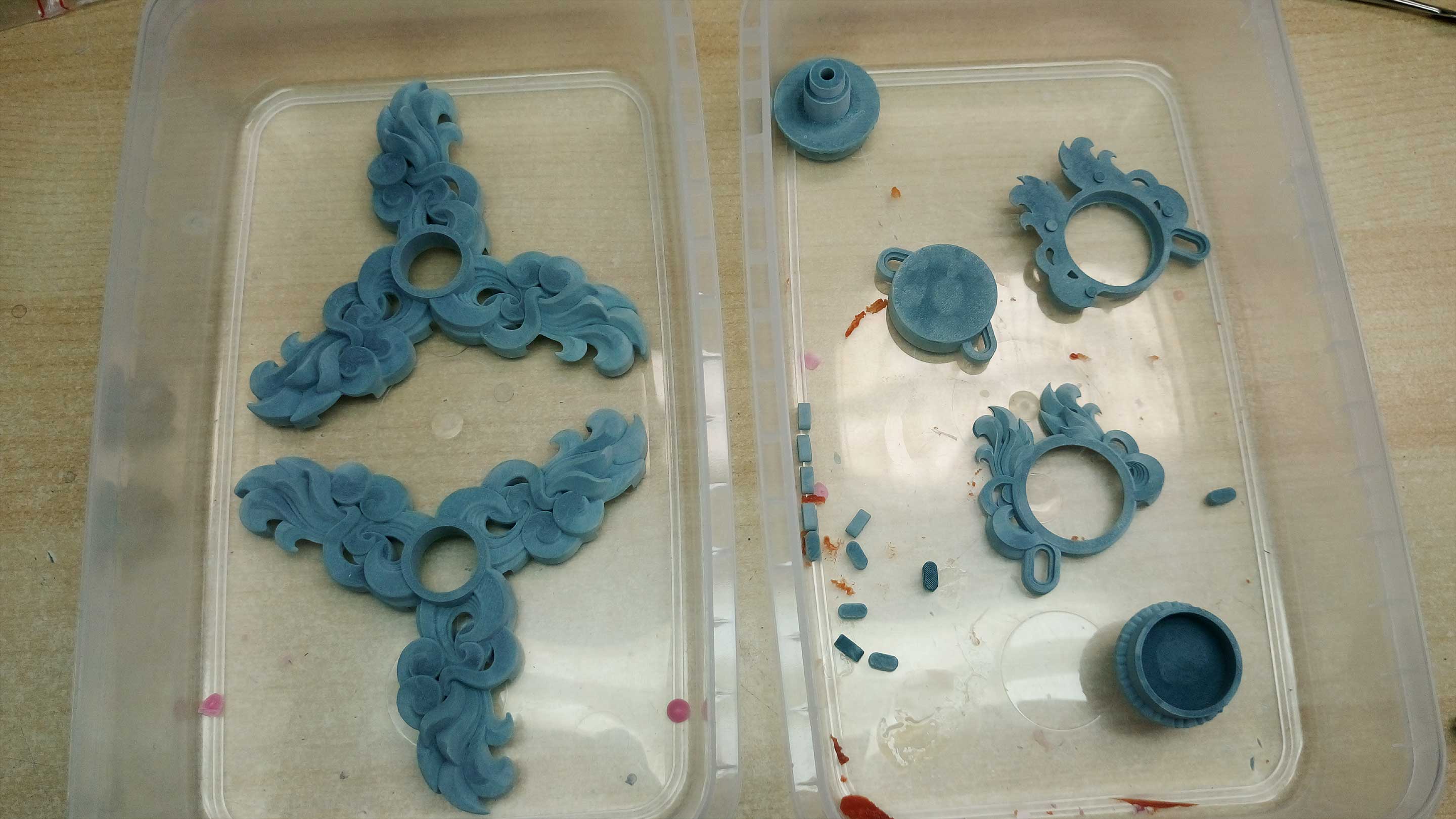

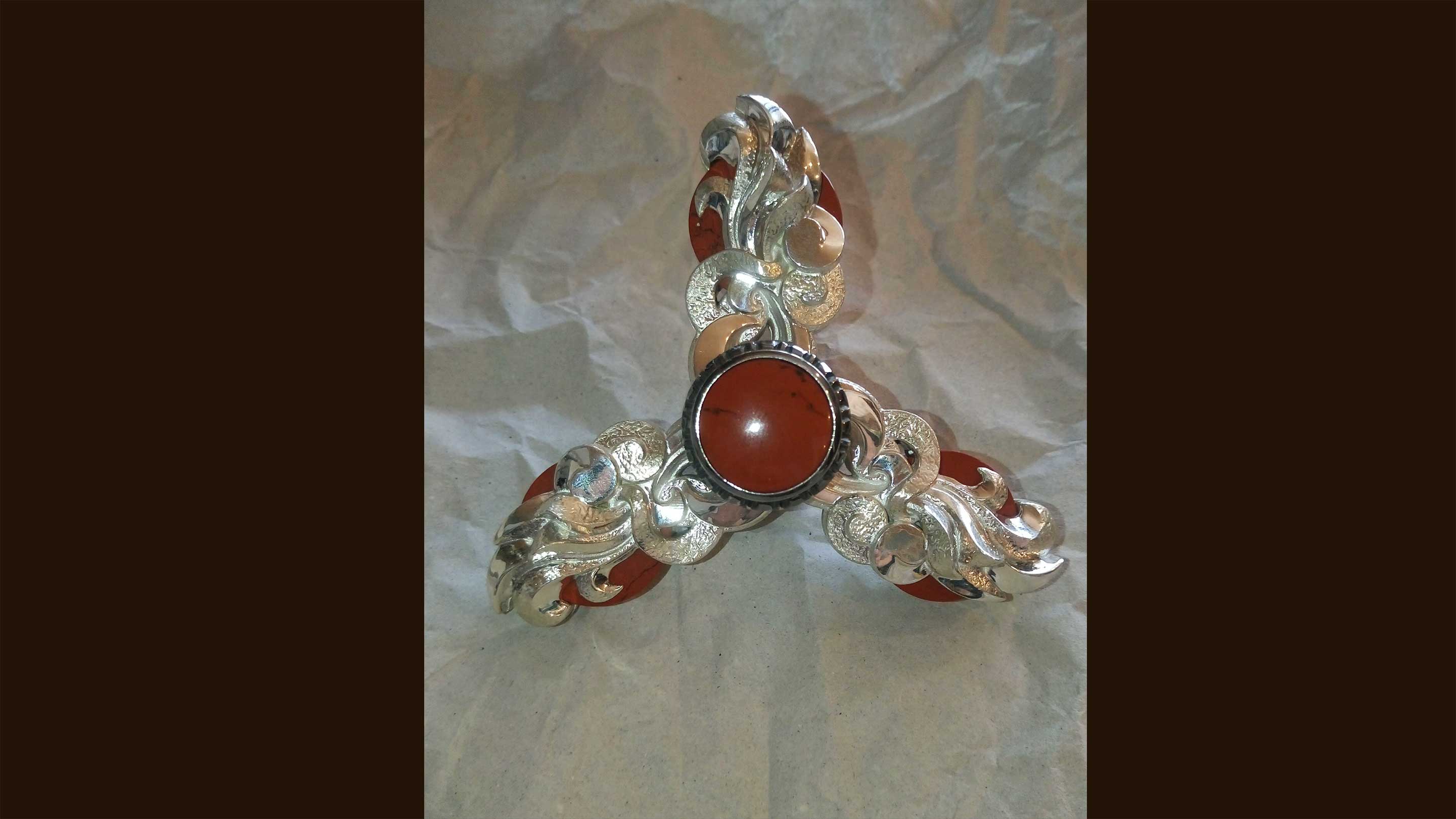

Dear Zbrush community,
i want to show you another work i made entirely with Zbrush.

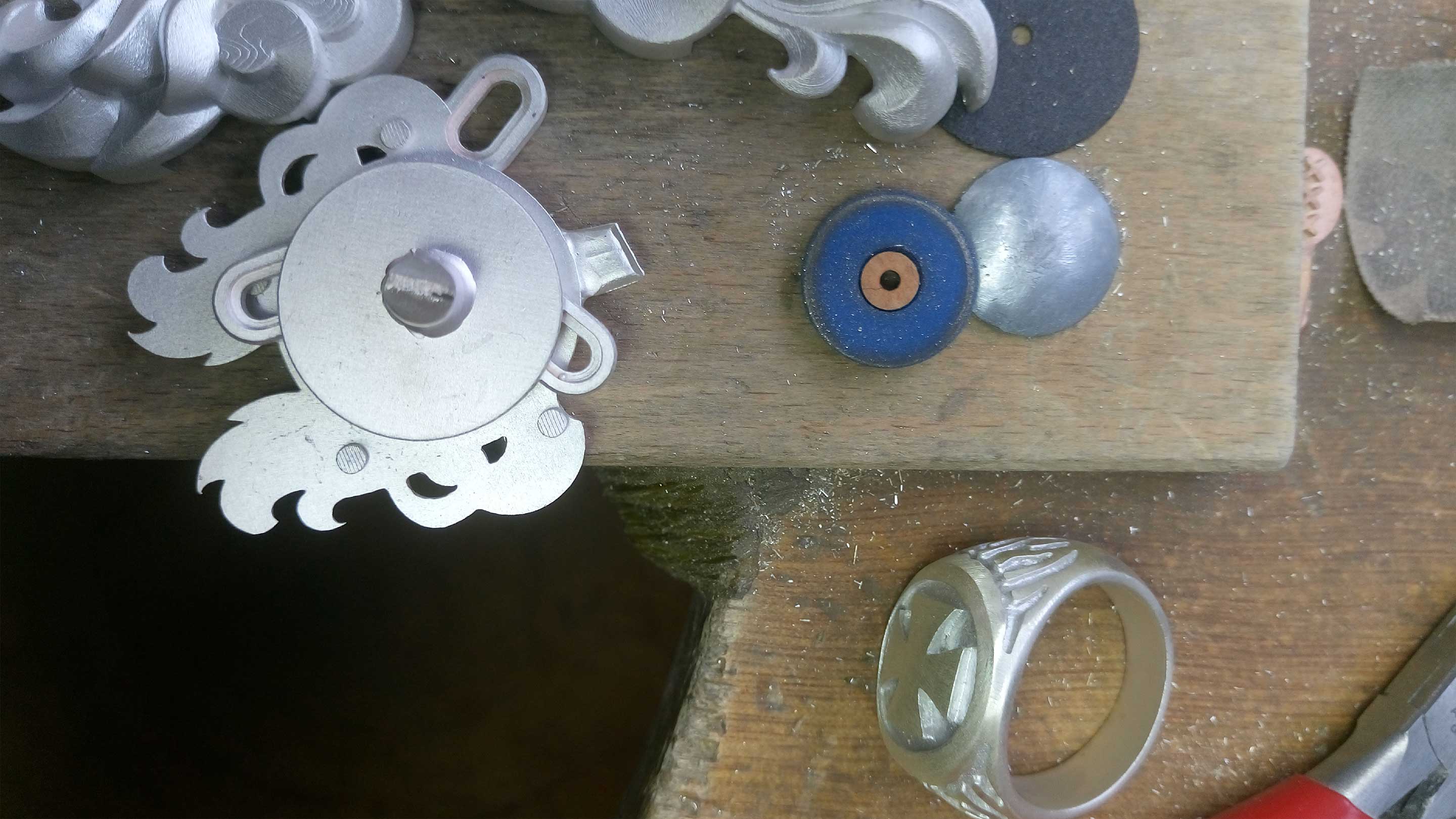

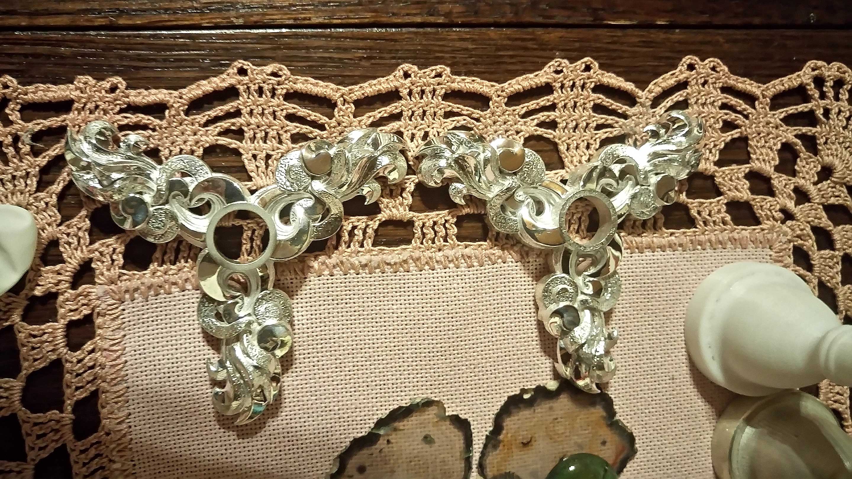

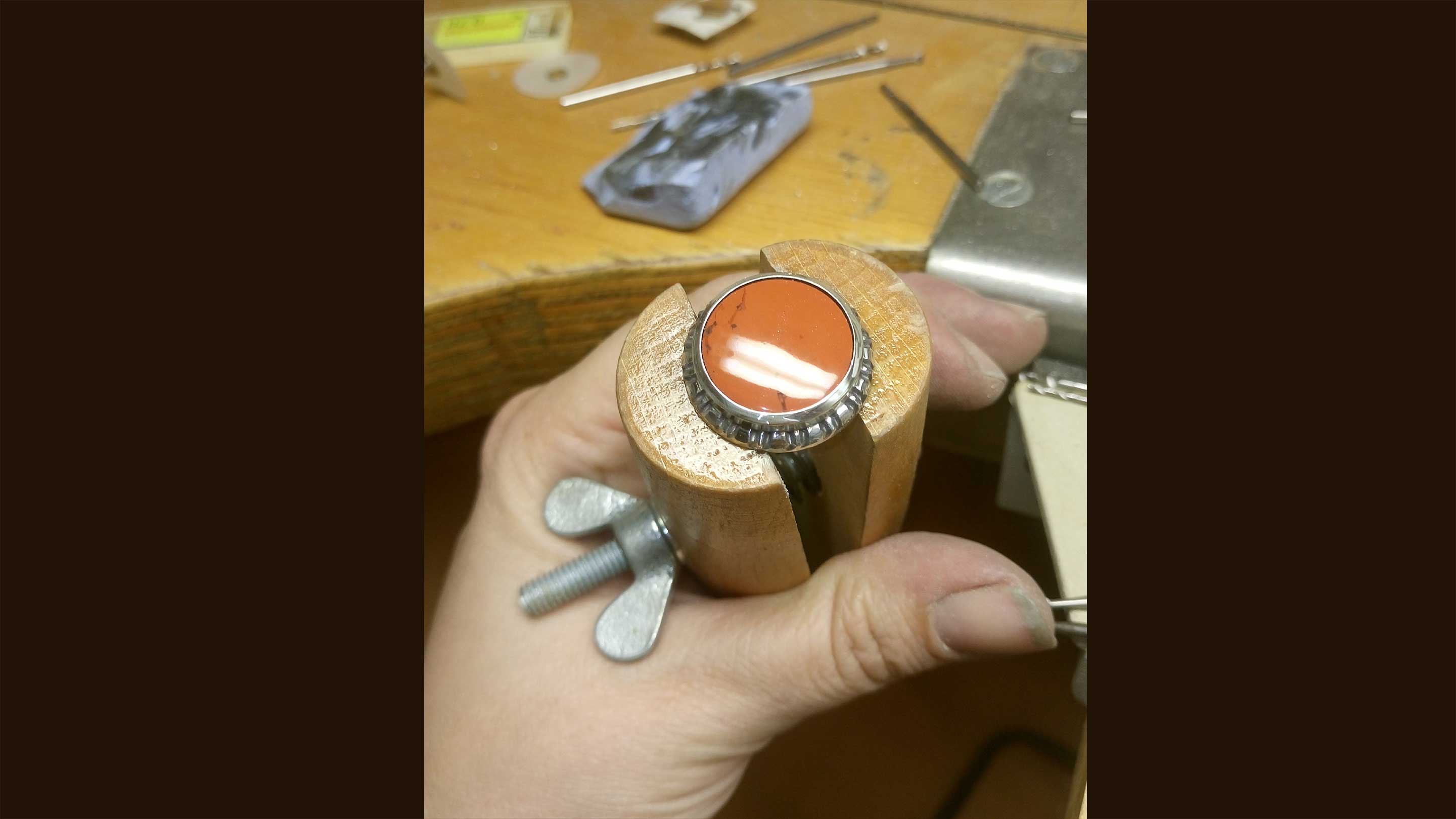

A friend of mine, Carina Conzelmann is a professional goldsmith and
she 3D printed this on a solidscape 3dprinter and then cast it in silver.
it was out entry for the german gemstone competition 2017.
the weight of this piece is around 210 grams and it has a nice feature.

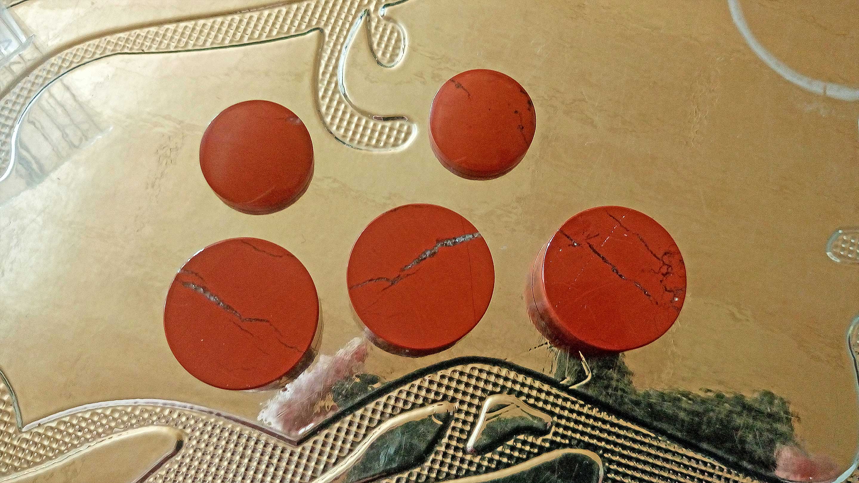

It is basicalla a fidget spinner but the outside ball bearings for the weight
were replaced by jaspis stones. and you can change one of them out of the little
capsule and replace it with the holder so you can play with it.
it was a very complex & time consuming project for both of us but i think it
came out pretty nice. and at this point i want to say again thank you to carina
for doing an awesome job.
For my part / 3d - Zbrush with Live Boolean in the pipeline again never let me
down when there were changes to make during the developing process.
Both shells hold together with small neodymium magnets and what can i say:
it spins for a very long time :slight_smile:
what do you think ?
Love, all the best & keep up zbrushing
Cosmic
