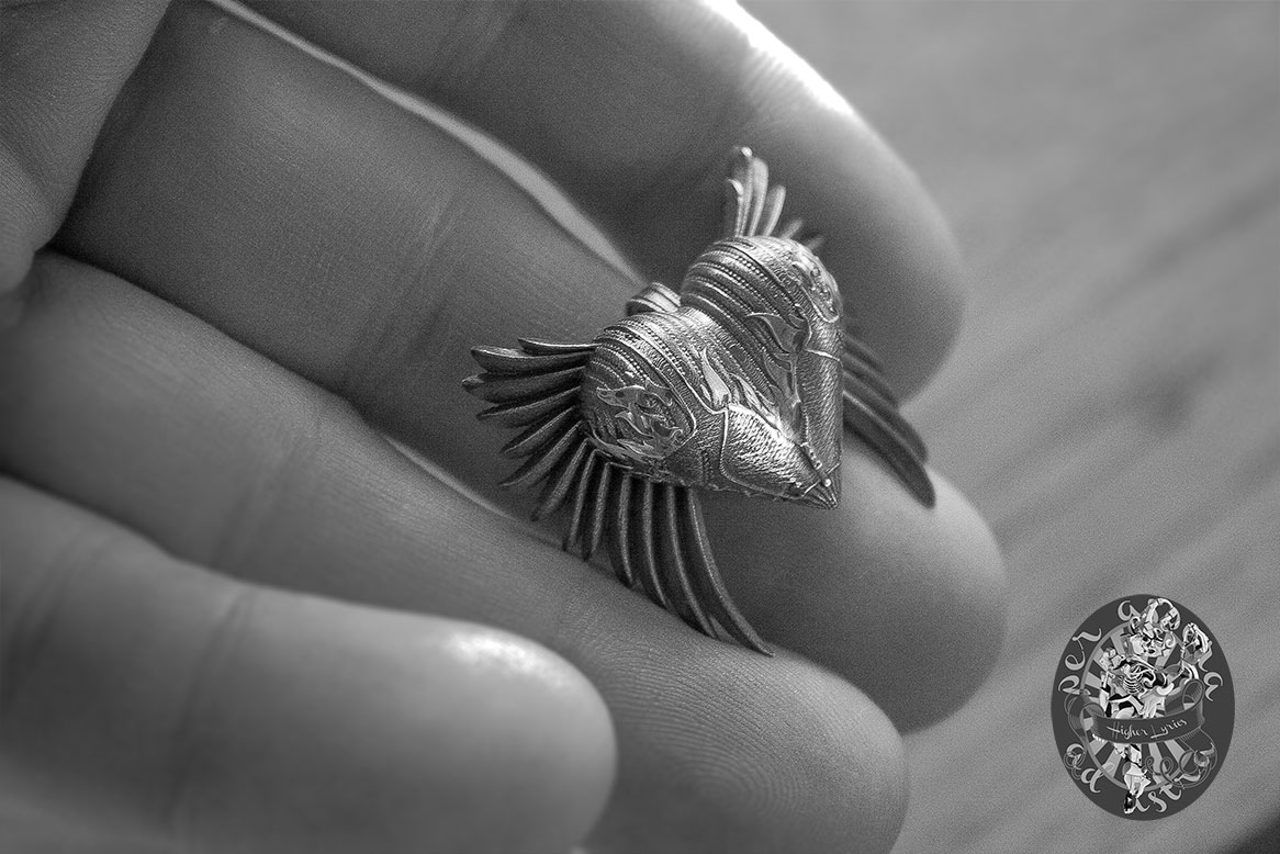

This is a highend 3d print / sterling silver cast of the winged heart.
the photos can´t nearly desribe the the real look, feel and amazing quality
of this piece. i hope you like it. cosmic of higher lyrics

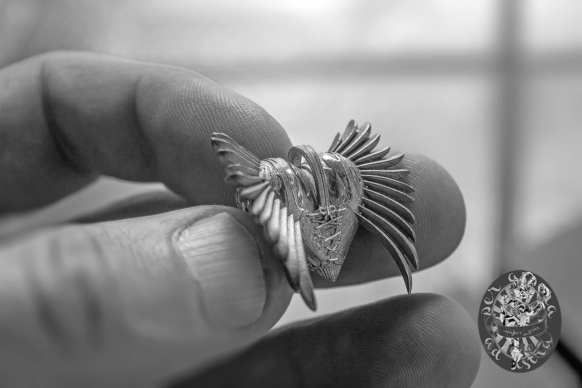

Sweet. Do you know what the resolution of the 3 D print was(layer thickness)?
That is awesome. Can I ask if you needed to do any finish work to the piece (tumble, polish?).
Thanks for sharing.
Dan
Great work this… well done!
Which printer was used for the Wax Model?
Keep it up!
thank you very much.
@doug: i dont know exactly i think something around 0,025 mm or less
@dfuriano: thank you
i have a jeweler and they do some additional polishing and
they also add some chemicals to darken it a little.
@sigmund: thanks. i dont know to be honest. i have a company and they do all the
“non computer and printing work” for me. i just know how to model the objects

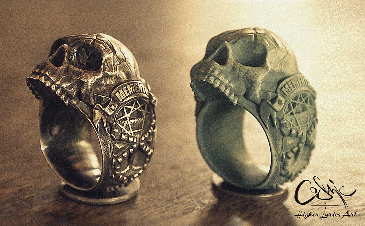

memento mori silver skull ring. on the side there´s a sandglass
and “sand” within. reminding the person wearing it being mortal and that life is
a gift and you should enjoy life and use the time wisely.
almost 90 grams of 935 type silver
that´s pretty heavy - but heavy is good
on the left side there´s the silver cast with final polish & on the right side the wax
printed version of it.
i hope you like it.
cu cosmic

Yet another cool use for ZBrush.May I ask how do you deal with obtaining an accurate size?

@monstermaker: thank you sir. it´s pretty easy: i create a cylinder in zbrush, cut of
the top - delete hidden - then i use 3d print exporter to set the exact size. after exporting
i reimport the reference model and append it to my ring. then i do resizing of my ring,
delete the reference and export the ring - that´s all. works perfect and accurate.
