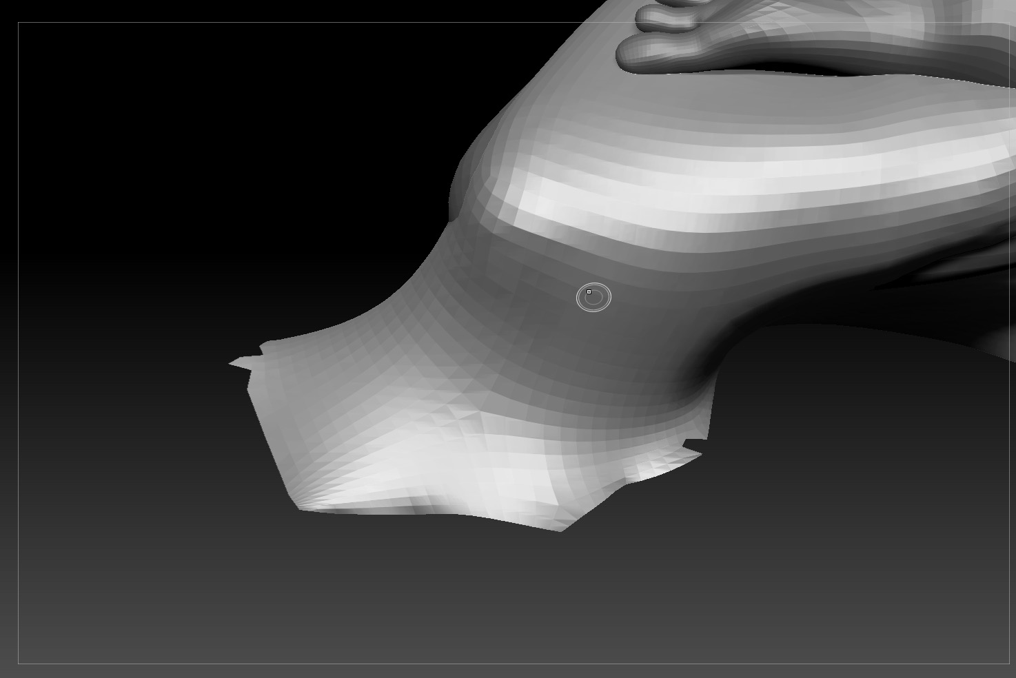

Hello Zbrushers,
I am trying to sculpt the dress of a seated woman, and I am trying to do it with an open mesh. the base form i started with was a tube, open at both ends. as i sculpt is i am using zremesher which seems to work ok but it creates jagged parts edges.
I am finding it hard to smooth out these parts. does anyone have any suggestions?
i know one solution would be start off with closed mesh and use dynamesh but the flowing edges of this dress are an important feature and i don’t know how i could capture is with a closed mesh.
Have you tried the option freeze border in zremesher? That would avoid the jagged edges probably.
