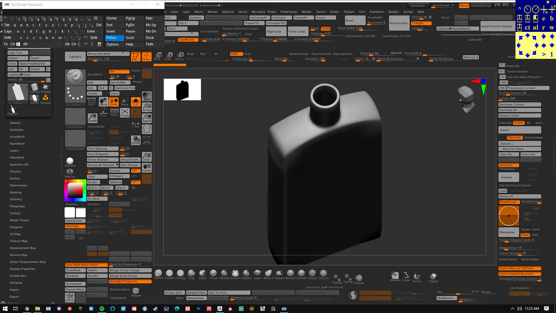

I used Zbrush dynamesh, zremesher, polygroups. It has an inside… I used Modo to unwrap… If I didn’t have to use a foot switch, this would take about a hour
@PaulGaboury I know someone must have thought of this. I used dynamesh, it is a sphare that I cut up with a cylinder in it… Dynameshed and made a copy, scaled that down a little and made the cylinder taller so it would cut out the inside… Boolen the two subtools,… Zremesher with polycons. Projection… The lid is a cylinder and on the top I used multiple edge loops with interactive elevation
