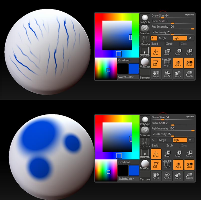

The Standard Brush should be able to drag rect stroke paint as well as the Paint brush. It’s just a matter of settings.
Couple possibilities off the top of my head.
  1. The Alpha “A” Button is not enabled.
alpha
  1. The alpha may not actually be assigned to the brush. Remember that you have to assign the alpha for each individual brush. If using a custom interface, one issue to look out for is that some of the smaller Alpha selector buttons can glitch out, showing the alpha of the previous brush being active when it actually isn’t. You still have to click on the selector button and assign it.
Thanks for the reply, You are right. I went back and noticed alpha was not on…So i guess the silver lining is now I know a work around. Thanks for the reply.
