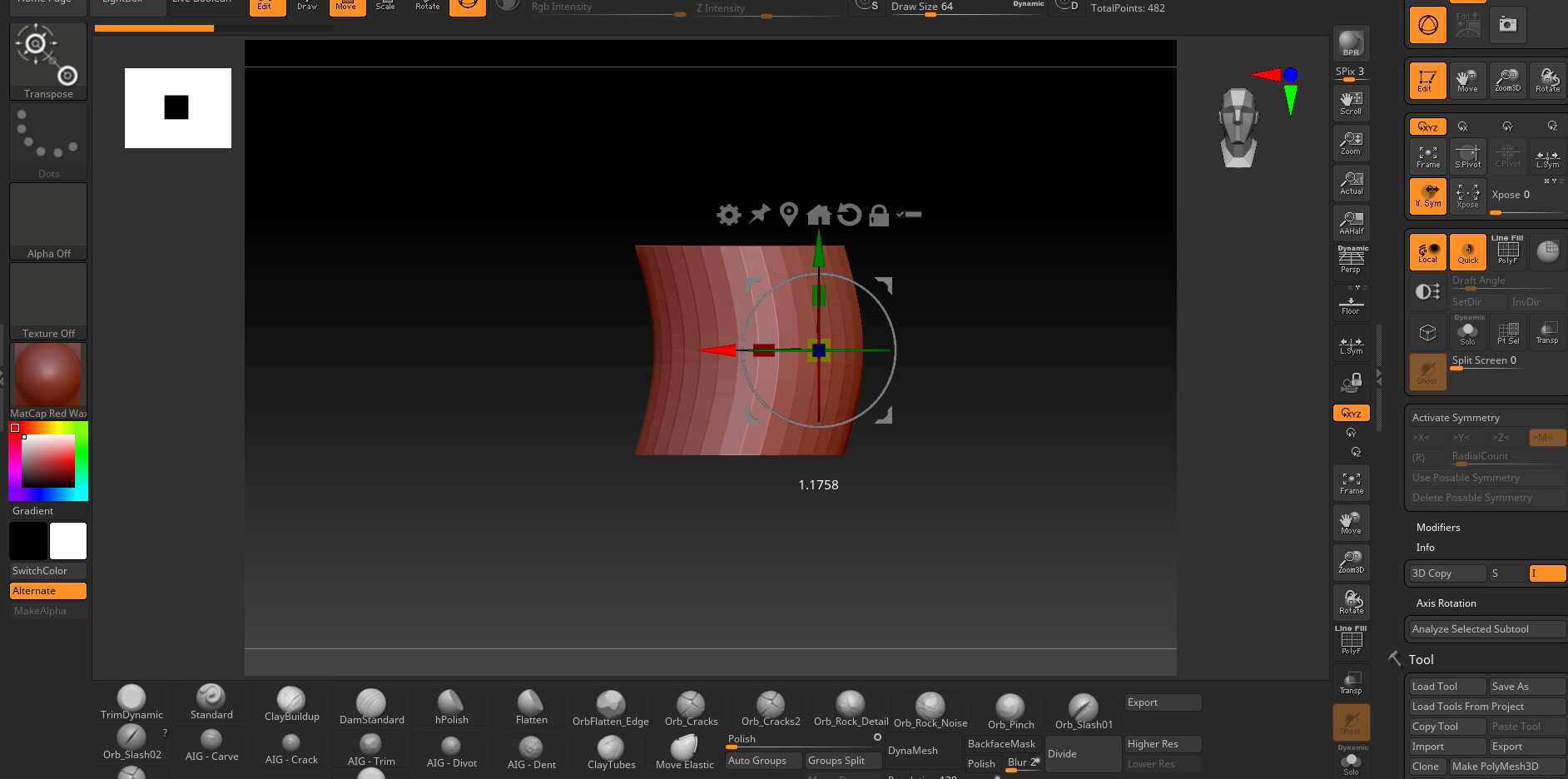

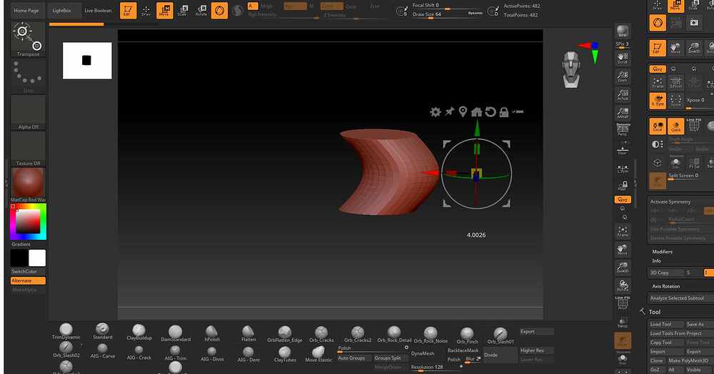

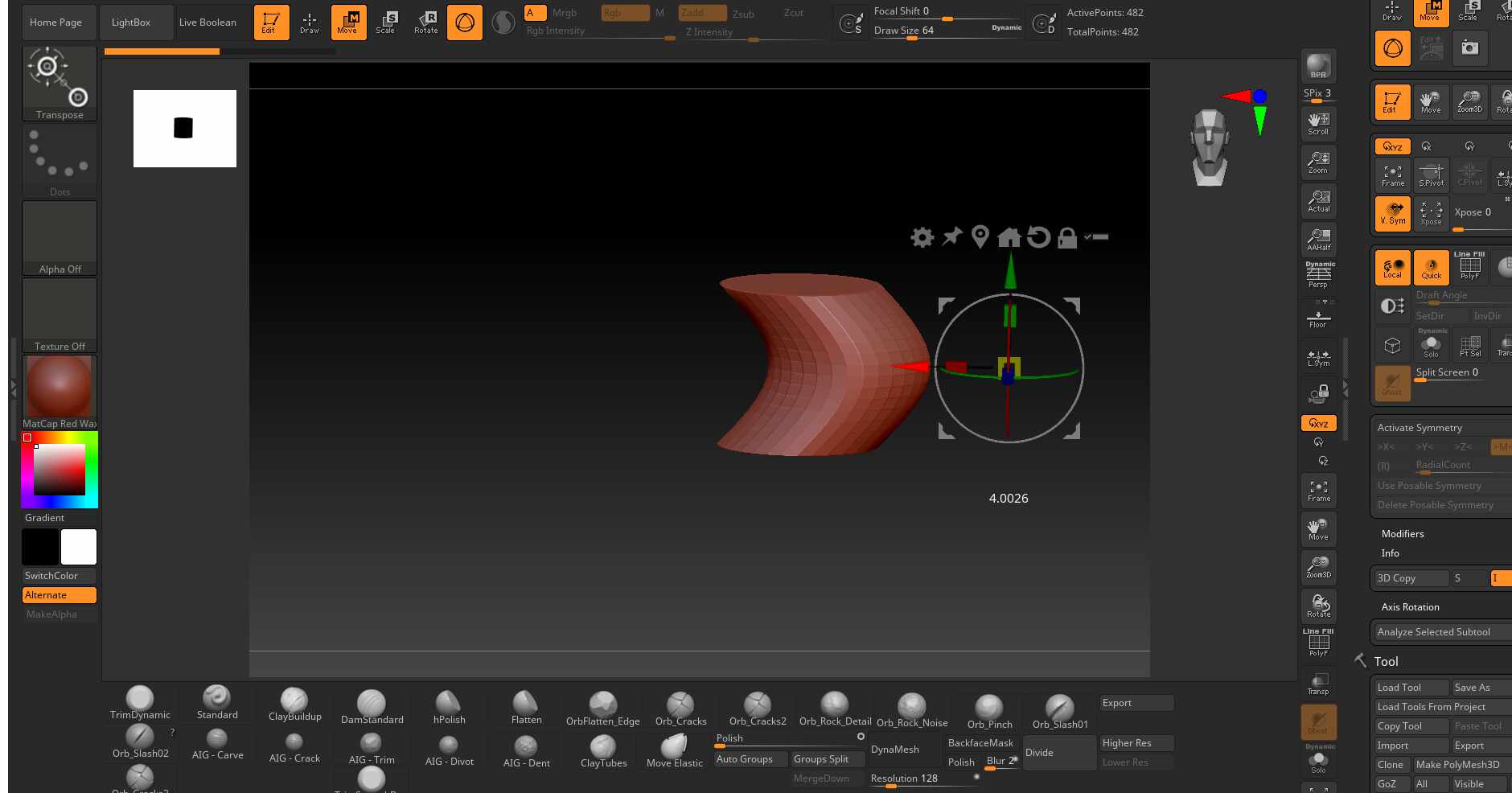

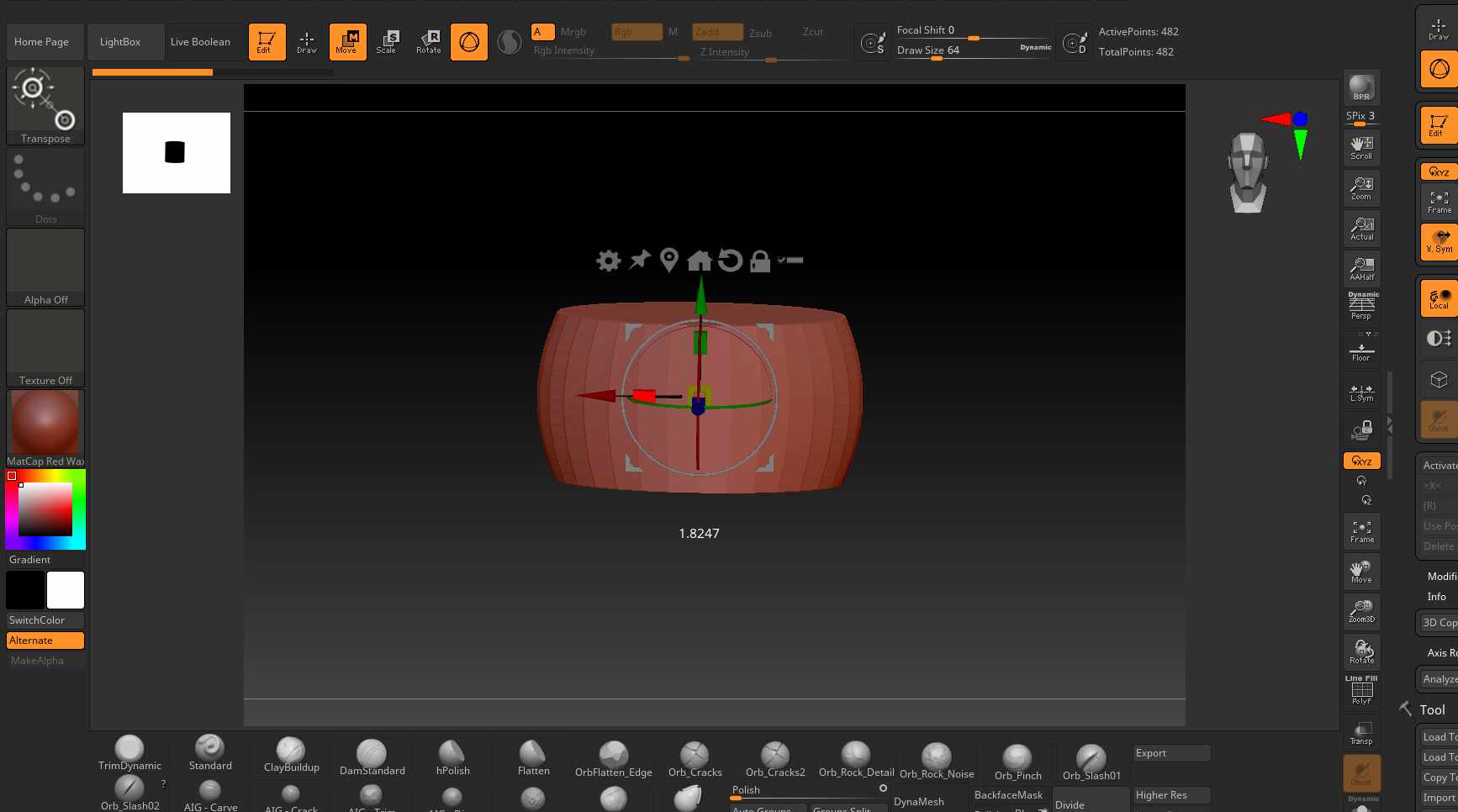

Greetings zbrush community, I ran into a random issue today when loading up zbrush. It happened mostly after the new update.
The issue is whenever I use the move gizmo tool it does random actions. For example if I use the move arrows to move the subtool it actually skews the model in that direction. If I scale it actually tapers the model on one side. It looks like the pivot or origin point is moving also away from the model which seems to be the issue but idk how to fix this. So I’m not sure what happened or if theres some setting on. I just want the mesh to move normally how it used to. Please any help would be appreciated. Here are some images of the issues in action. I really need to get this down because I have a project to work on soon.
Images of issue:
Hi @Zephyrs_Domain Welcome to ZBrush Central!
That is because the 3D Gizmo now utilizes the Focal Shift slider for deformations. Set your Focal Shift to -100 for normal transforms.
This solution didn’t work for me. Is there any other solution?
that worked for me, many thanks
