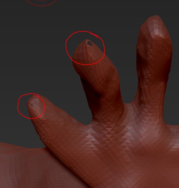

Hello Zbrush pepole,
I have the problem with my model (picture attached).
I am modeling fingers but I have issue with two fingers - holes in them. I would normally use dynamesh to fix that issue but I already have some divides with details on the model. If I would use dynamesh, I would lost all subdivisions.
Can you please help me with that? What is the best way to fix that?

You can try: Tool>Geometry>Modify Topology>Close Holes. You’ll need to freeze subdivision levels first. Or you can duplicate the subtool, delete the higher subdivision levels before closing the holes, then subdivide and project back the details.
