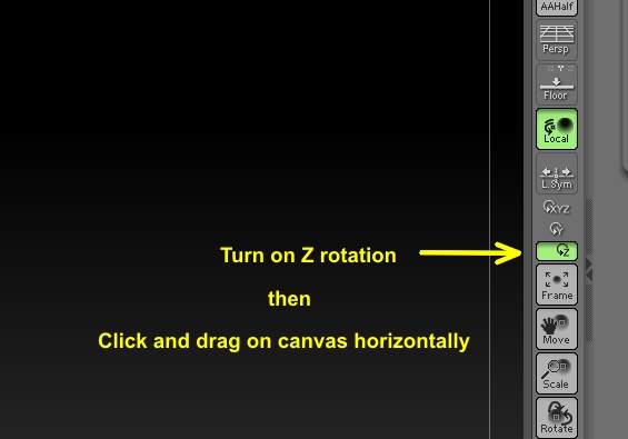

See image below.
That only works if you happen to be facing directly down the z axis. We need a button like that but without a letter in it. I am guessing that there is no good solution for this as I have not come across it since I have been using zbrush.
