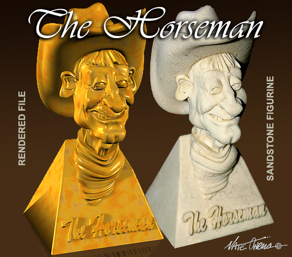

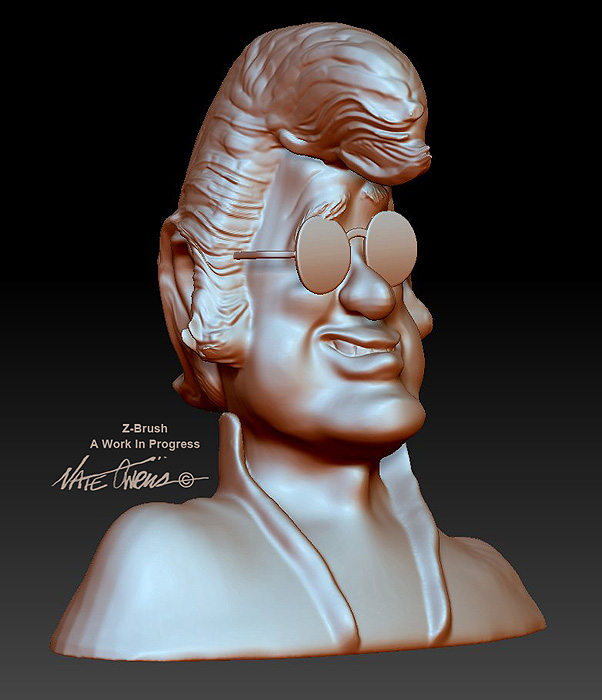

My themes are in illustration and figurines (3D print)
Regarding retopo in ZBrush I find it’s greatest asset is in simplifying the painting of objects, mapping color to them and in creating cleaner files, usually with smaller file sizes.
The cleaner meshes are also an asset in making files that are “printable” for figurines…
