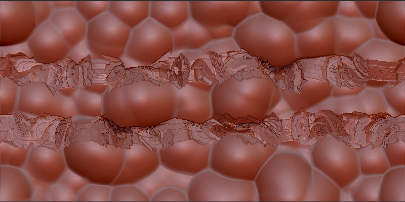

I don’t know how to paint in Zbrush other than poly-painting and 2.5D but is this what you meant? (no dry dirt, just mud bubbles, and no wheels, just a trail of gears. (hideous pun intended). (This has an example of the annoying line at the top).

PS: If I can get rid of that line I’m going to go berserk with this tool, its a stunningly cool feature!!!
-EDIT: There is also a small ripple at the edge going from top to bottom, if you place this on or in something that can repeat it you will notice it quite clearly
Kirkl, I have been screwing about with this a lot since you brought it up and while its very cool I cant seem to hide the artifact on the edges, not much fun…
It seems to be more of a rendering issue like Zbrush is rendering a shadow for the edge of the window or something, very strange…
I can post more examples if your curious.

Sorry, I still don’t understand what are you talking about? I don’t use the 2,5d method as aurick offered because it seems doesn’t allow to make AO or cavity masks for color painting. If you are talking about 3d way on a square plane, it looks like Zbrush can’t handle uv without at least one pixel border so it gives you a small edge.
