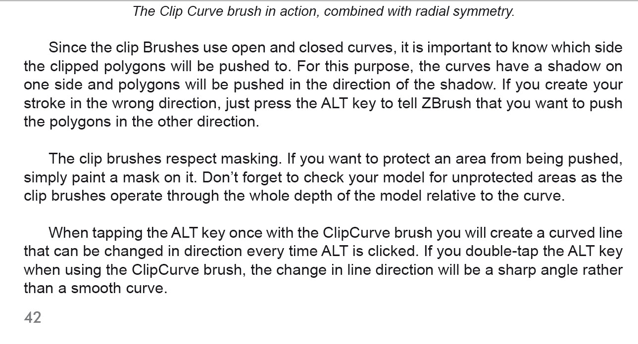

look here:probably is what you are looking for:D
Yes, I read this before, but this works only with the clip rectangle/circle…with the clipcurve, when I press the alt key, I start a curve, but I can’t invert the direction of the shadow…
in the video the up and down drag direction give the shadow to the right and the down to up drag direction give the shadow to the contrary
