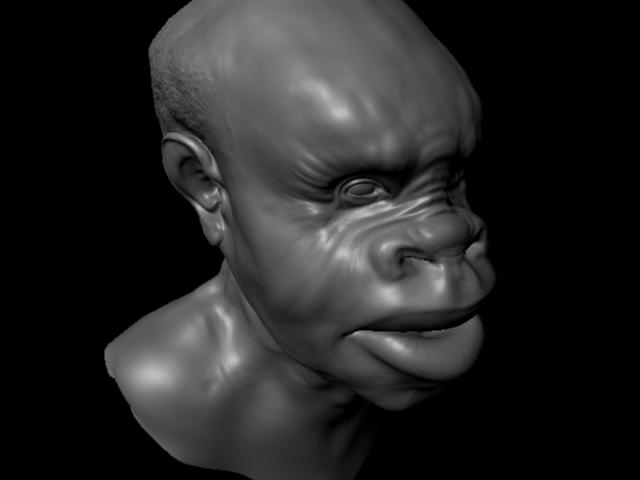

the mel works fine regarding hte approximation
but i guess its missing something , or I am
cause here is the result i got with the head from this thread
Rendering ZBrush Displacement-Maps In External Renderers
it looked like a bump map
yes, i got the same result as ashaiad vbmenu_register(“postmenu_179215”, true); .:qu:
thanks to Miguel Ortega
here is my work flow
first get the image from zbrush , open it in photoshop , then image auto contrast
open maya
get the obj file , run the script choose the image
disable the bump map
and it should be fine

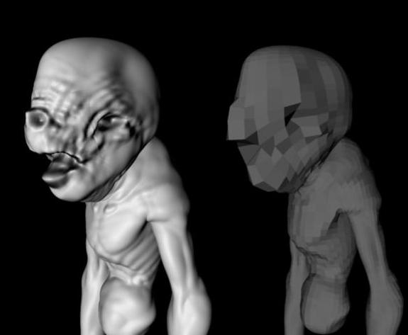

Hello.
I’ve download the script and i’m able to run it in maya 6.0.
I download the sword obj and displacement tif from zbrush’s site.
I bring the tif into Photoshop, auto contrast, run zatt6, render with mr and get the results you see in the attached images. ?
any ideas from anyone why?
tia!
Looks like your displacement map is flipped vertically.

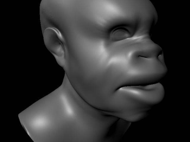

I love the script…very easy to setup…
I’m still not getting the kind of results I need though…
The only way I could get any detail out of the displacement was to smooth the mesh unstill it had so many polygons I could barely even rotate in 3d.
If I have to subdivide it that much…I might as well just import the thing from zbrush…
Should I convert it to subdivision surface and do it that way?
When I did that the results looked no better than the displacement on the unsmoothed polygon head…
what am I doing wrong?
-tiktok
I disabled bump…
then punched up the alpha gain to like 9…and the detail suddenly popped out!!!..
