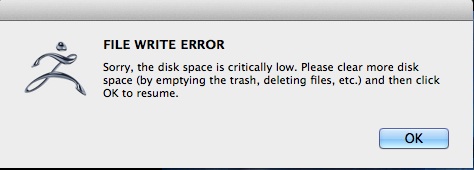

Hello,
ZBrush launch an error telling me that my disk space is low when I try to use zremesher. A pop up opens and I can nothing but force zbrush to quit. I have 679 Gb available on my disk.
What should I do to solve that, please ?
Thank you
Are you using ZB 4R 6P2? What OS?
I´m not a Mac user but i believe this is caused because you have Zbrush installed in other partition rather than the OS is installed. Zbrush installs a VMem folder which is very heavy when working and can cause those problems. If that is your case may be some one here could tell you in your OS the location of the txt file that has the path for the Vmem.
In Windows it´s located in: C:\Users\Public\Documents\ZBrushData. there you can modify the ZBrushScratchDiskPath txt to any other location in your PC or Mac i guess
Hope this helps
I’ve upgraded to P2, and the error has disappeared. I’m on OS X Mavericks.
Thank you :slight_smile:
