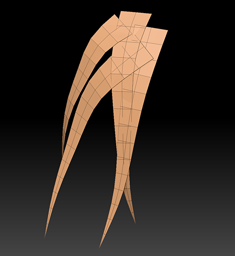

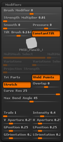

I’m trying to creare some low poly hair strands for a character I’m working on, so I’ve create a new InsertBrush using a polymesh plane with UVs.
Here’s my brush settings:
I’ve then activated the Curve mode under the Stroke panel, and started drawing some test curves.

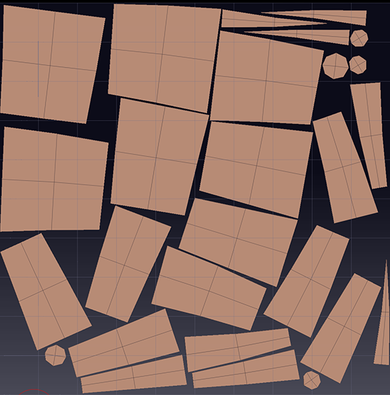

Now, looking at the UVs, I was expecting a single shell for every hair strand, but instead, every plane, it’s self contained into its own UV island.
How you can imagine, I need to set a texture with alpha infomations on each strand, and that’s impossible with this UV layout.
So my question is:
In this case, it is possible to create a new InsertMesh brush which merge UVs to create a single shell out from any curve?
