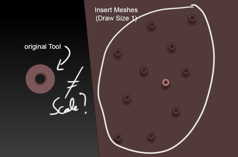

I’ve been struggling with this for a while now. I make an insertbrush from a subtool. Then, when I set drawsize to 1 and insert it on another mesh it has the wrong size. No matter what draw size I set (4 is close but not exact), I can never insert the subtool at it’s original size. It’s important, because it needs to be 3D printed and have accurate size. Off course I press control when inserting the mesh.InserMeshScaleIssue

Is the picture an accurate representation of what you’re trying to do–duplicating that element at the same size along a planar surface?
In that case it would be easier and more precise to simply create the element as a subtool to the target at exactly the size you need, then duplicate it over an over by control-dragging with Gizmo mode (will duplicate unmasked).

Thanks Marcus_Civis, IMM Draw size plugin does the trick. It was also suggested by Joseph Drust via Zbrush.
Spyndel, that’s exactly how I go about doing things now. But I wanted to speed up the workflow…
