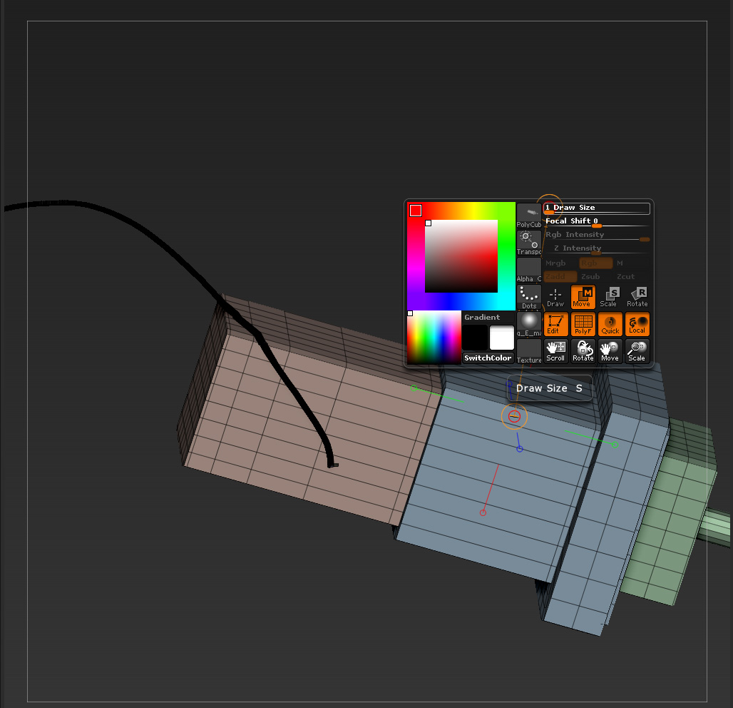

This is what happens when I right click on the transpose line, in any part of it. Right click pop up menu, every time…
Does the menu still pop up for you guys even when you’re holding down the RMB? If you you might need to go to Preferences: Interface: (Nagivation) and check that Right Click Navigation is turned on. It should be on by default, and when it is, gives perfect behavior. If it’s off however, you get exactly what you’re describing.

Right click and drag to inflate, if only right and release click it opens pop-up menue.
Ah, that was it! thanks Cryid!
You have to have “RightClick Navigation” turned on in order for the right click actions on the transpose line to work! I copied my preferences from zb4r3 where I had it turned off.

Make sure you have the Preferences>Interface>RightClick Navigation turned ON, otherwise this will not work.
Got it!!! Sorry for all of that. But by habit before Zbrush 2 i disable right click navigation; is one of the first thing I do…
Now i will have do do with right click navigation.
thanks Cyrid and Marcus.:+1:
