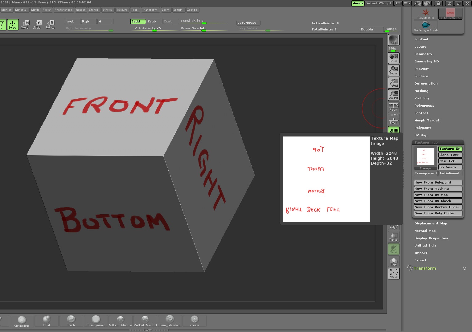

It sounds like there is something wrong with your UV map. Like every face of the cube is just plied up on top of each other. Check your UV map in ZBrush by going to Tool > Texture Map and click ‘New From UV Map’ and see if it’s still the same as it was in Max. It seems that ZBrush doesn’t like having the uv islands right on the edge of the map and that could cause problems. In the cube example below, I did the UVs in Blender. Imported the cube into ZBrush and created a new texture then used Projection Master to paint it without any problems. As far as GoZ and Max goes, I don’t use either, so I can’t help you there.
