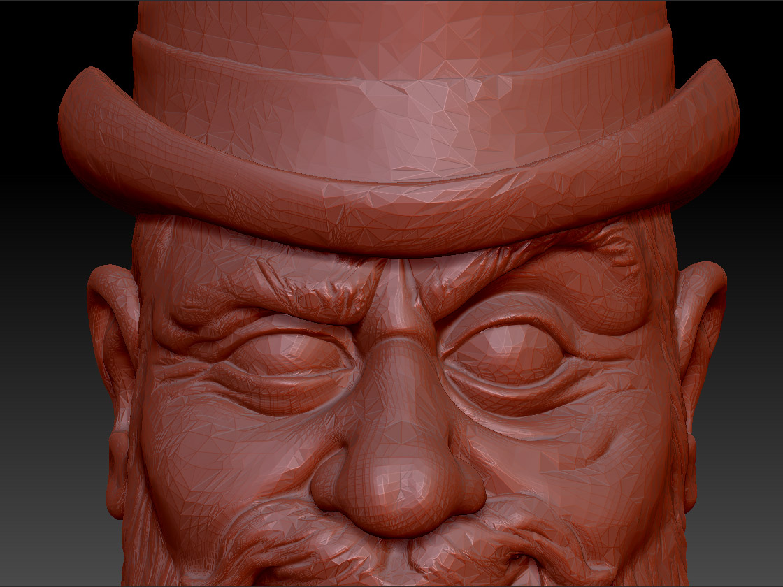

My current client has laser scanned one of my sculpts for rapid prototyping and wants me to emboss some text onto the 3D model before it is printed. I thought it would be fairly straight forward but am struggling from the start!
When I import the .obj mesh (which was converted from nurbs by the scanning company) it seems very low res and slightly corrupted. I’ve attached a screenshot.
The scanning company say the file is fine. When I use Tri2quad slider and subdivide, I still can’t seem to smooth the mesh.
I had assumed I would just import a perfect mesh and emboss the text. Am I being unrealistic? Or is the scanned mesh to blame? When I convert the tris to quads on import the resulting mesh has only 115,000 polys. I would have thought it should be in the millions for a laser scan?
