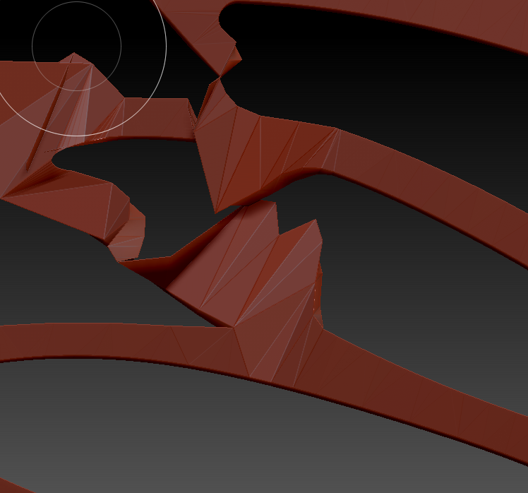

When i import from rhino 3d as an obj or stl file its very faceted to work on in rhino.
Is this an import setting or an export setting from rhino ?

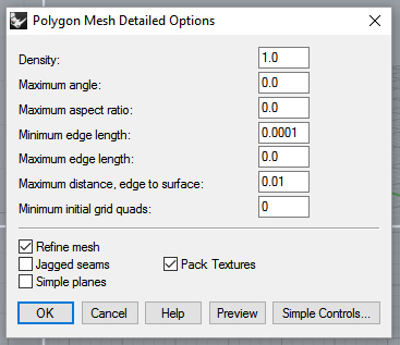

When you export stl’s from Rhino, you should get a popup with Polygon Mesh Detailed Option:
The image shows my go to settings that generally give me a good base to start working on in Zbrush.
Hi thanks. Tried that but still the same ?
Any ideas ?
