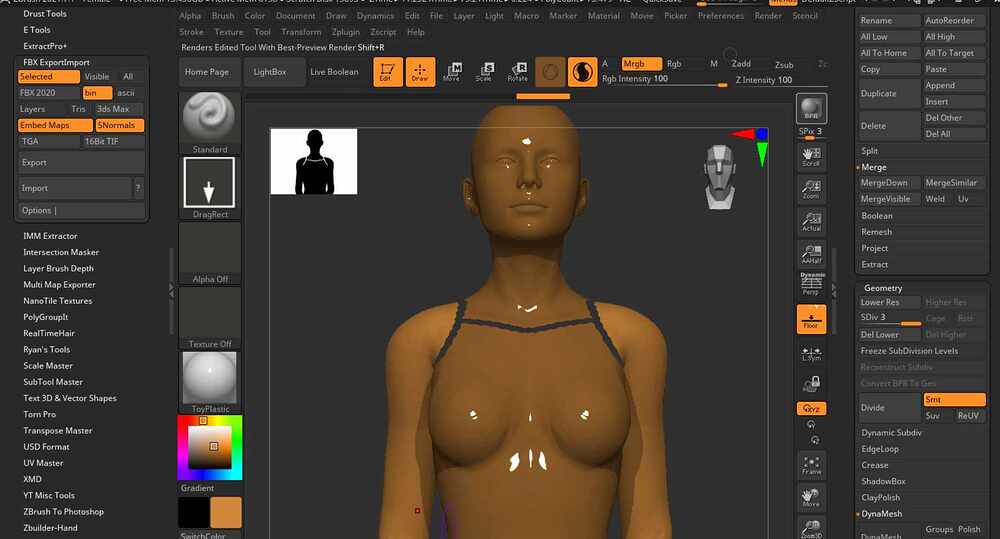

I trying to import an fbx file with a view to adding texture maps to it. It’s a female form which is split into subtools such as head, arms, legs and torso. If I subdivide the individual subtools, the geo is nice and smooth but they split apart, leaving a gap inbetween each one. I can then add the texture maps to each individual subtool however I can’t then knit the whole model back together.

Turn on Polyframe (Shift+F) and see if each section has it’s own polygroup. If it does, then, before you subdivide, go to “Tool > Geometry > Crease” and click “Crease PG” button (crease polygroup borders) for each subtool. You can then subdivide and you won’t get the gap. If you have to stitch everything back together later, you can use “WeldPionts” (weld identical points) in “Tool > Geometry > Modify Topology”.

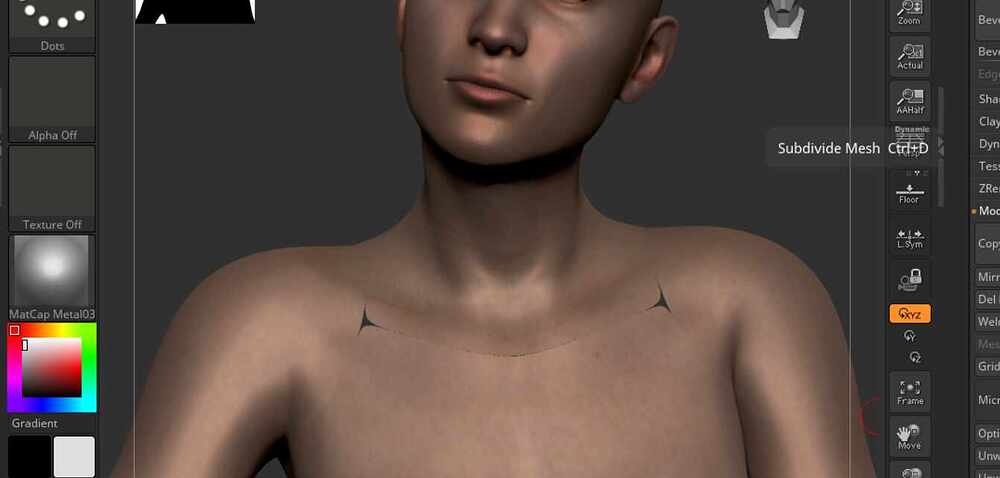

The gap is reduced but not gone but we’re getting there! I tried on this OBJ rather than FBX (not sure if that makes any difference at all) but still get little gaps as you can see:
Not quite sure how to use the ‘weld points’ to get the desired effect! (and keep the texture on).
