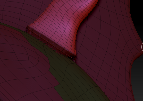

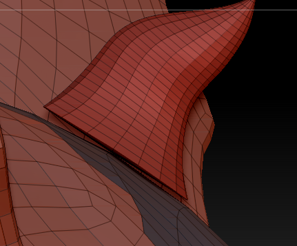

Hi all, I have searched until my head hurts lol. How do I get an IMM brush to fully weld on a curved surface? The weld points look horrible after any re-meshing.

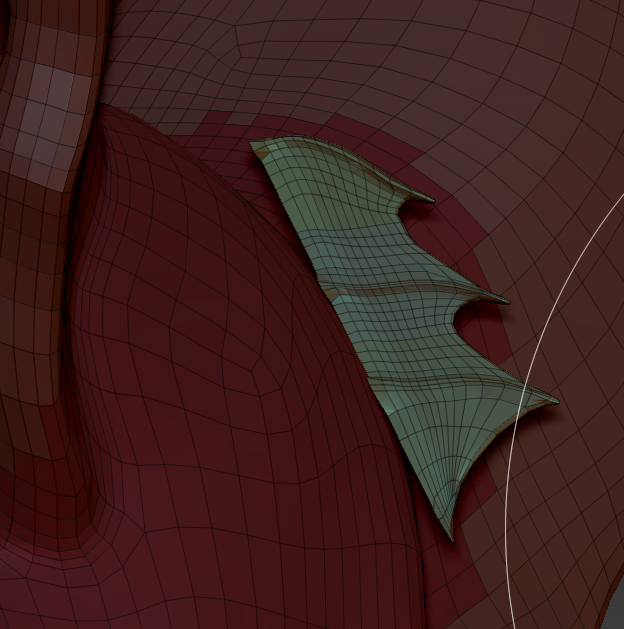

thank you for the information. I followed the steps in creating a connection and I am just getting the same result. My brush is connecting to the surface in the very center and thats it.
What do you think Im doing wrong?

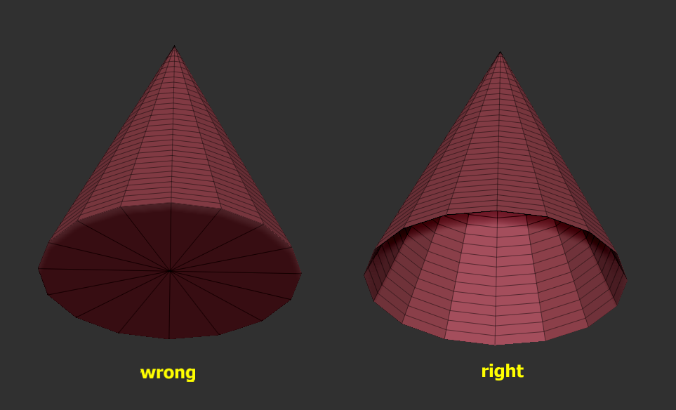

Do you have the bottom open? It can’t be a closed mesh.

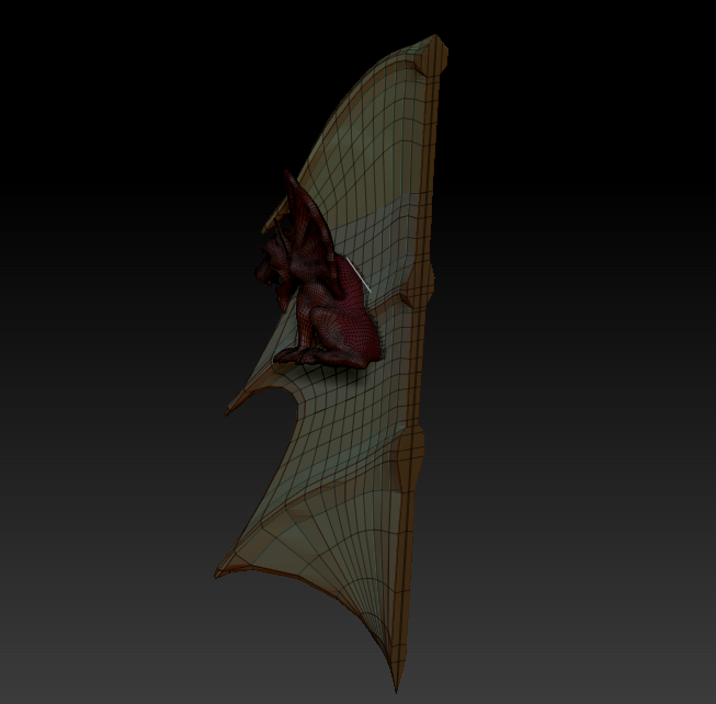

Ok, I can understand that, so I downloaded a brush instead of making one for now. Im trying to weld a spike to the back of this gargoyle. Still, no go. The behavior is the same. And with curve activate it turns the brush around and make it huge.
