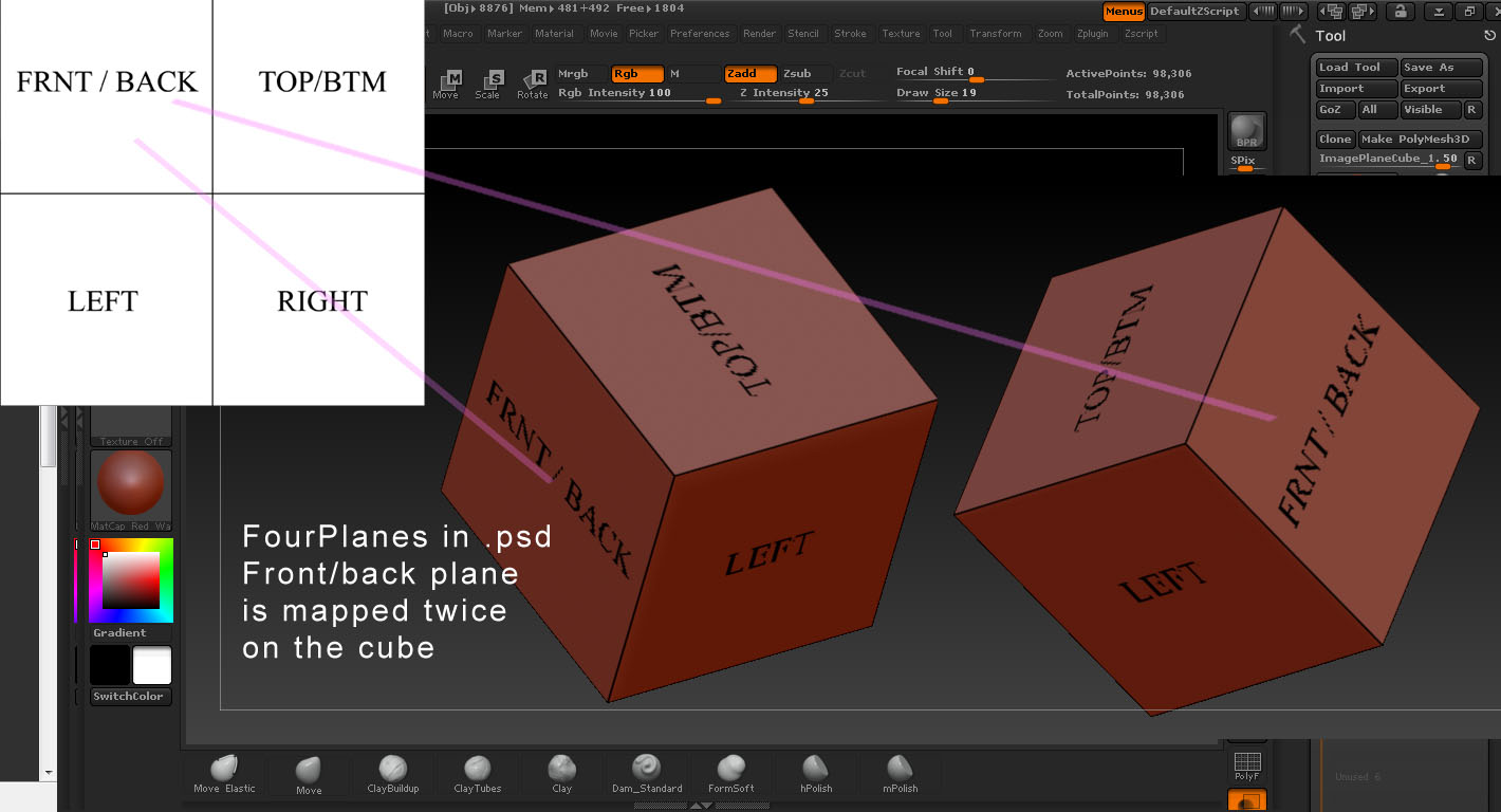

Hello! I just started creating an anatomical model of the arm. I am starting with the bones. I happen to have references for four views: the Front, Back, Left and Right. I want to to use the ImagePlaneCube for setting up my reference. The UVs on the ImagePlaneCube map only the Front/Back, left, Right and Top/Bottom ( four Images ) of the .psd. Basically I can’t have the front and back load at the same time as Front/Back is repeated. Is there a way i could have the ImagePlaneCube have six unique planes of reference UV mapped with an associated .psd file which has six boxes ( Front, back, Left, Right, Top, Bottom )instead of four. Some help will be greatly appreciated.
[Untitled-1.jpg]
You’ll have to set up your own box with a unique UV layout for the views that you want. There isn’t a different mesh that comes with layout you need.
