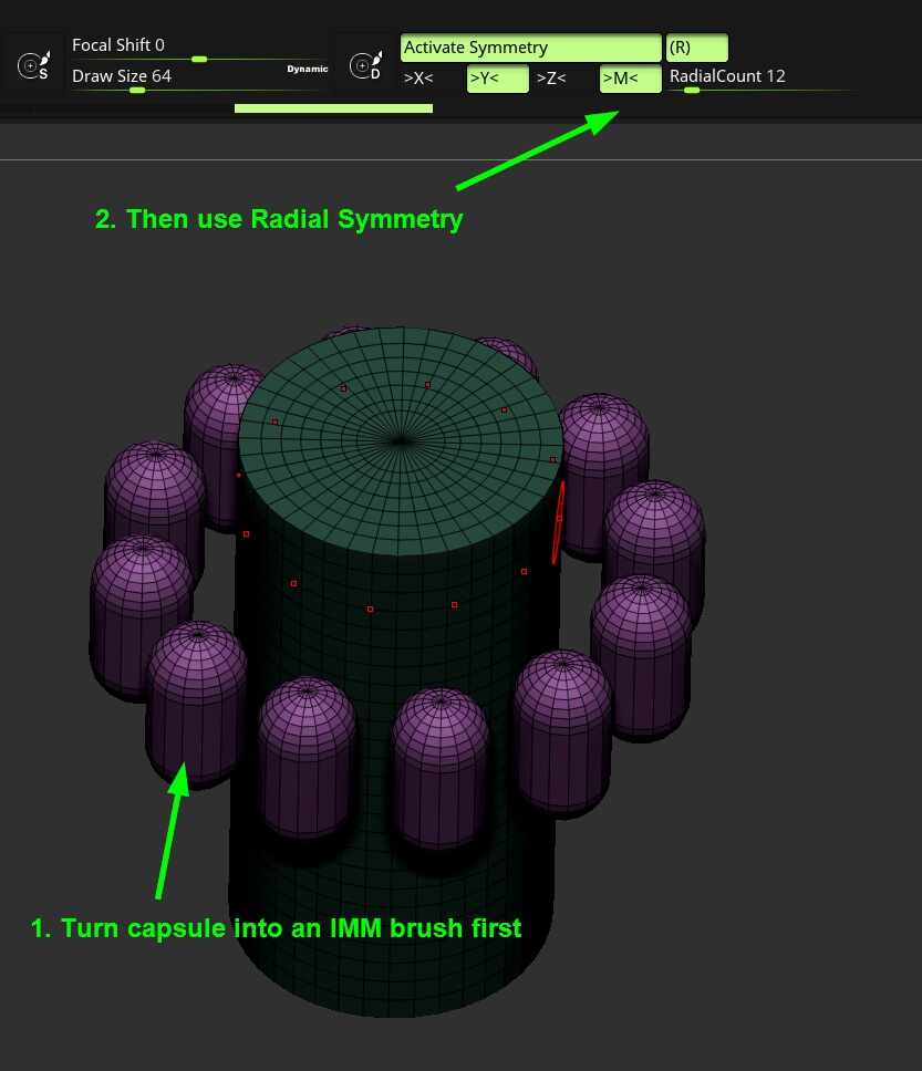

Is there a way to make the gray block rotate around the blue block?
I learned about arraymesh in the Transpose section… but I couldn’t get the center of the blue block.
:point_down:
You can also use Radial Symmetry instead of ArrayMesh.

I’m on ZBrush 2022.0.8 version. The links you posted to the 2 files don’t work. Files aren’t usually backwards compatible anyway. I can’t guarantee anything but I’m willing to take a look at the files if you fix the links.
