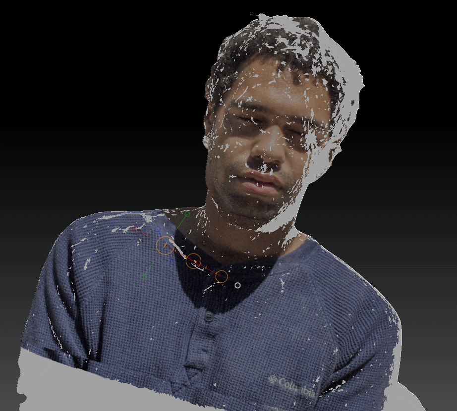

Hello, I’m using projection master with the settings “color” and “double sided” selected, the result adds the texture, except for a bunch of blank patches all over the model? Does anyone know what could be the issue?
here is a screenshot:

I added the photo to show what it looks like
I used to get that issue in 4R4 (which was when I first used ZBrush), but it hasn’t happened since then. I had a video card go bad around the same time and replaced it and I was never sure if the bad card contributed to this or if it was just a bug in ZBrush.
Are you using 3D Layers? They might cause problems. Also, it’s important not to have Flat Color material selected as this doesn’t work with Projection Master.
