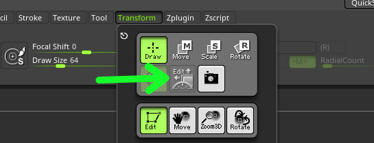

I try to press z to hide the dial and nothing. I hide spotlight and bring it back again.
Try to press z to unhide the dial. Nothing.

Hi MAH,
The button for that is in the Transform palette. Just assign Z to that button. You need to load a texture into the texture palette or the button will be grayed out.
Nice! Once again! Worked like a charm. I don’t know how I broke my ZBrush so much.
Here I want to get back into it two-fold and I keep hitting speed bumps. Like Spotlight, I want it to be behind my model so I can use it as a reference and not for texture. Was searching for a way to do that when I realize it was broken.
